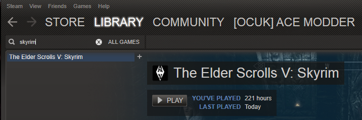

hmmm, well I have had an hour on Skyrim, come out and noticed no glitches. they would have happened by now.
However I think I know 1 other thing that may have been causing it...
The END mod for skyrim the author suggests keeping v-snyc disabled for some reason, I had it enabled in the Nvidia control panel, overwriting the mod disabling it.
That could have caused the glitch issues. TBH the only game I tried was skyrim.
