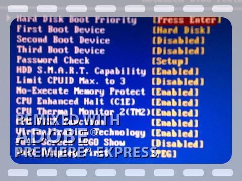

YZFAndy, I see you have all the items enabled in bios that iv been told to disable.
