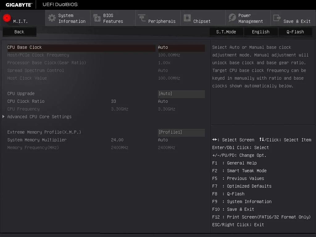

Just to confirm something.. When you go into your BIOS and select F2 to go into detail; in the M.I.T section you have selected under the "Extreme Memory Profile (XMP)" section "Profile1" haven't you?
Yeah that's correct mate. I did it the day after I built the PC as I questioned in another thread about it and was told it's so the RAM does in fact run at 2400Mhz and not 2133Mhz.

I wonder if the setting the xmp profile is buggy on this board (x99-sli). I only say that because it seems to what caused issues for both of you.
It didn't occur to me in the other thread (damn you x99), that although I've had no memory troubles with mine, I didn't enable the xmp profile because Crucial made the jedec profile and the xmp profile the same on this memory (ballistix sport 16gb), so it's the correct speed (2400) and timings by default.
I wonder if the setting the xmp profile is buggy on this board (x99-sli). I only say that because it seems to what caused issues for both of you..
I think you are right Armadillo. During my conversation with Gigabyte support I did suggest this and they didn't deny it, just said thanks for the feedback. Within a day of that conversation BIOS F2b came out ;)
