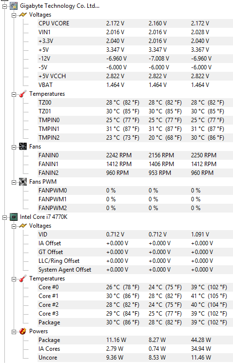

Edit, just seen your HWmonitor pic, hmmmmm.

This being said the BIOS is reporting about the same VCore readings.
Im guessing CPUZ is taking the CPU's Voltage sensor and the Gigabyte software and UEFI are taking the motherboards voltage draw sensor

Definitely appears to be faulty/buggy sensors though.
All of the voltage readings from the motherboard in HWMonitor seem to be incorrect. If you look down to VID under the 4770k it's showing the correct voltage.
If it were truly putting more than 2v through your 4770k it'd be long dead by now.
EDIT: Just seen the board has voltage read points. Probably worth checking them with a multimeter to see if it's hardware or software issue.
yep,it would be "frying tonight" with 2v
I reckon you have either buggy software hwmonitor or a stuck sensor
its normal for the voltage to scale up and down according to the cpu loads,but it shouldn't be hitting 2v if it did it would kill the cpu within seconds/minutes
