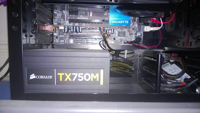

This is what I'm working with, so it'll be tight for space either way! Unless I get a card with a pciex1 slot.
