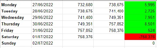

I'm using Google Sheets for tracking a currency and I thought this would be a simple thing to do but I can't seem to get it right.
In column E I have a formula D2-C2. In column E I have conditional formatting. If the number is positive then colour the cell green, if it's negative colour the cell red. Simple so far. But then I wanted to add into the mix that if the cell D7 for example is empty then the cell E7 should stay white. For the life of me I just can't seem to work out how to apply this 3rd condition. Would it be using conditional formatting, formulas or a mix of both? Example of table below.

I've tried using the ISBLANK function but I don't think I'm using it right. Is there a command for colouring a cell?
=IF D7 ISBLANK() THEN E7(insert colour command here). I know what I'm trying to do in my head but I just can't find the way of doing it heh.
I don't think that would work as the Cell won't have 0 in it. For the current day it will be empty.
You could default the values to zero, that way once the formula populates the currency column the difference column will update with a value.

=IF(ISBLANK(A1),B1,A1-B1)
Purely as an example, adjust cell references as required.
A1 would be the cell you're checking for a blank value, B1 is the value you use if that's true, else do the subtraction.
Breaking that down...
Code:
=IF(
ISBLANK(A1), if this cell is blank/empty
B1, apply this value
A1-B1 else apply this (this part is the equivalent of your existing formula, adjust as needed as with the rest)
If your empty cells might actually contain a 0 value, ISEMPTY might be more appropriate because 0 will evaluate to empty, but not blank (at least iirc).
