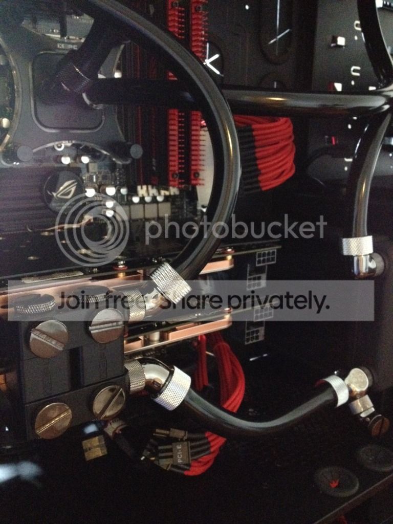

Never done SLI water before. Will this flow be ok with parallel. I was apprehensive to use the end ports on the XSPC razor blocks.
You won't benefit from parallel until you get to the outer for cards, also why the 45s, it doesn't look like you need them at all
Opposite corners(sides or ends) or both on side of one block I thought you had to have to get parallel flow. The way you have it there looks like it would short circuit the blocks. A little bit of flow would go through each block but the vast majority would take the path of least resistance, i.e. straight in and out via the square spacer nearest the tube in/out, and not going through either block.
So I I put line in to the hole top left in the pic this will be ok. Looking now common sense I guess. Late night early morning!!! Thanks for your help

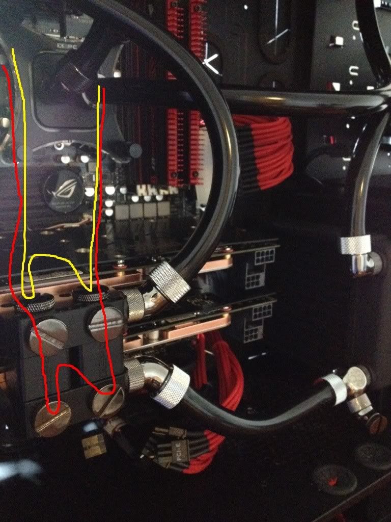

By way of some images. This is what you currently have.
Either of these you want, will give virtually equal flow through each block.

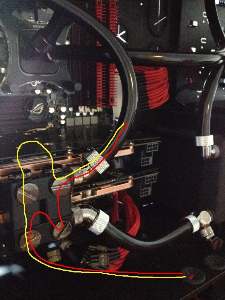

Or

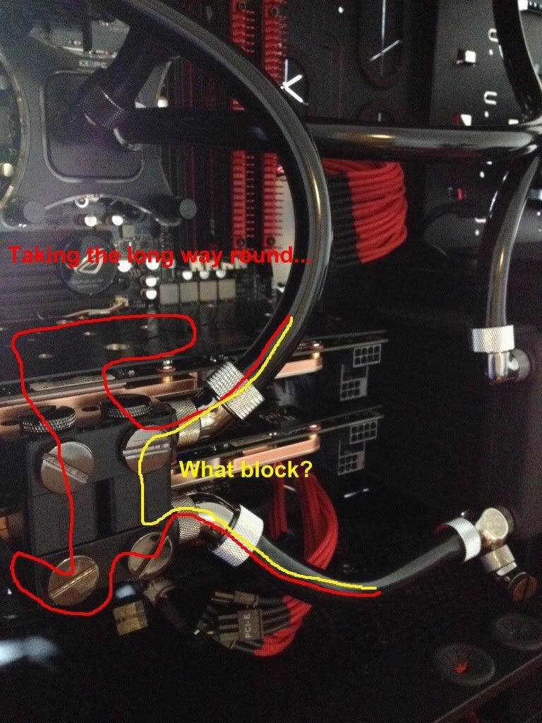

Or if you want to keep your tubes as you have, simply take out the right hand square spacer, and run it in series.
Top left in, bottom right out is fine, that's basically a mirror image of the second pic.
