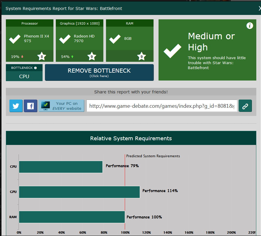

Ok well here is an example with the 7970.
Says bottleneck CPU but I have no idea how bad that would be.
If you agree its fine then between GTX 670 and HD 7970 what would be best?
Between those two I'd probably go for the 7970.
The website is right - you will be held back by your CPU, and your minimum framerates will be impacted.
But, your overall performance will still be better with that than a 7950. Even if 90% of the time the CPU is holding it back, the remaining 10% the GPU will still be faster. You'll see higher average FPS with a 7970.
