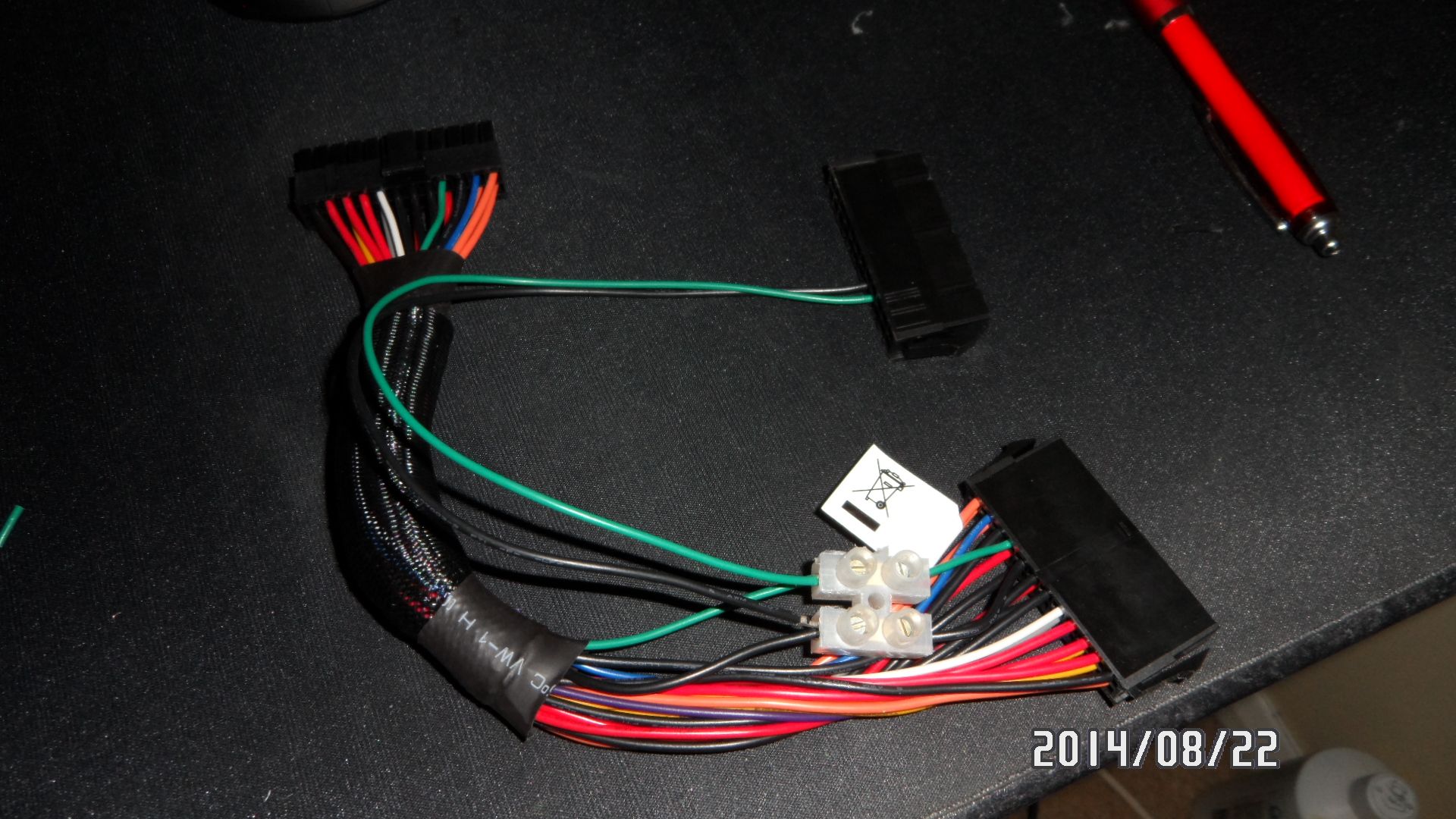

Got a 2nd psu now so should be able to push both cards to the max!!! Wonders what that draws??
Just need to wire up a dual psu adapter then i'm good to go ;)
