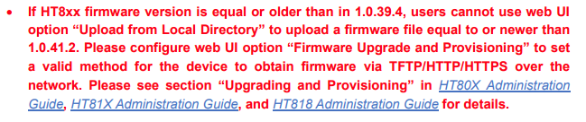

Having said that they're a set and forget thing, I'm reminded that firmware updates can be a bit tricky as not all of them can simply by done through the web management interface:
It's easy enough to setup a local HTTP server (I'll do it through Python on a Linux box), but it's a pain that it's necessary.
