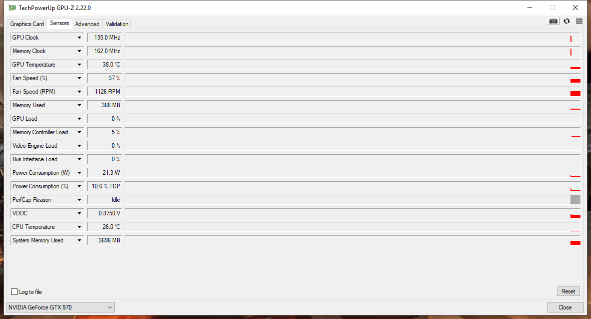

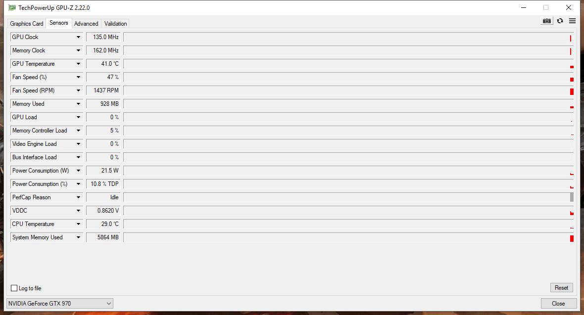

Hi here's the screenshots the 1st one is when 1st booted up 2nd is after a few hours on low settings
http://gpuz.techpowerup.com/19/07/08/tgx.png
http://gpuz.techpowerup.com/19/07/08/n35.png
nothing wrong with that looks normal fan is spinning. Now on the main GPU-Z tab look on the right of the window for the "?" press this then start the test. Should open a new window with a red moving picture. Now go back to the sensor screen and leave it for about a minute then screenshot it. GPU Load should be showing >90%
