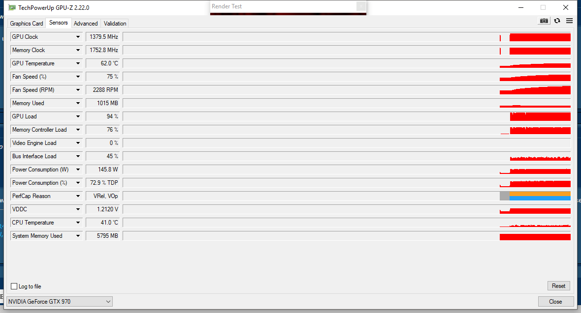

nothing wrong with that looks normal fan is spinning. Now on the main GPU-Z tab look on the right of the window for the "?" press this then start the test. Should open a new window with a red moving picture. Now go back to the sensor screen and leave it for about a minute then screenshot it. GPU Load should be showing >90%
http://gpuz.techpowerup.com/19/07/08/hbq.png
Hmm big magenta squares i wonder if the vram is going on it. Have u tried a few stress tests see if any pass ok?
You could maybe try underclocking the ram a bit or if not then the core see if that stablizes it a bit?

Thanks for your input but ram stress tests and ram underclocking are a bit beyond me i think a repair shop will have to be my next move, thanks guys i really appreciate everyone's input
