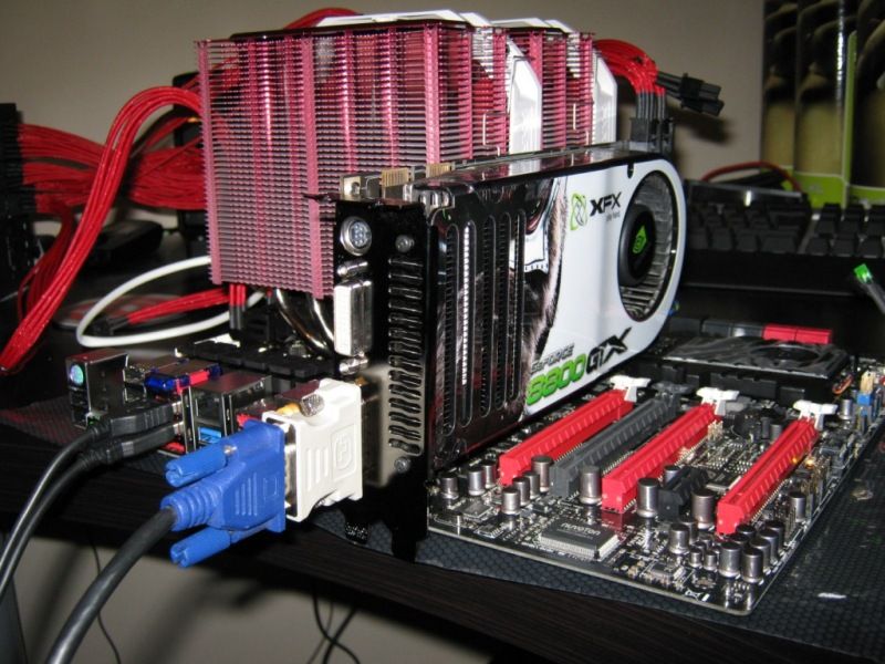

Current rig is this (E8400@4GHZ, GTX260, 8GB Ram)
As you can see it's been ages since my last upgrade.

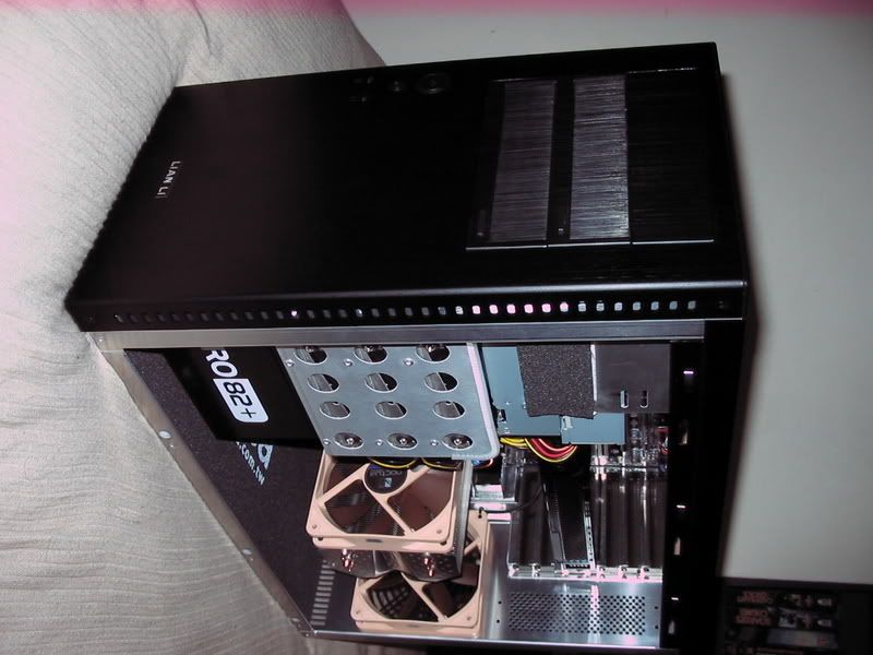

Current build is this, got an air cooler for a test run to check for DOA and broke out my trust 8800GTX :)
Having not run even SLI before let alone 3 or 4 cards any input on card choice/pitfalls would be appreciated or anyone else running similar res what graphics did you go for ?
