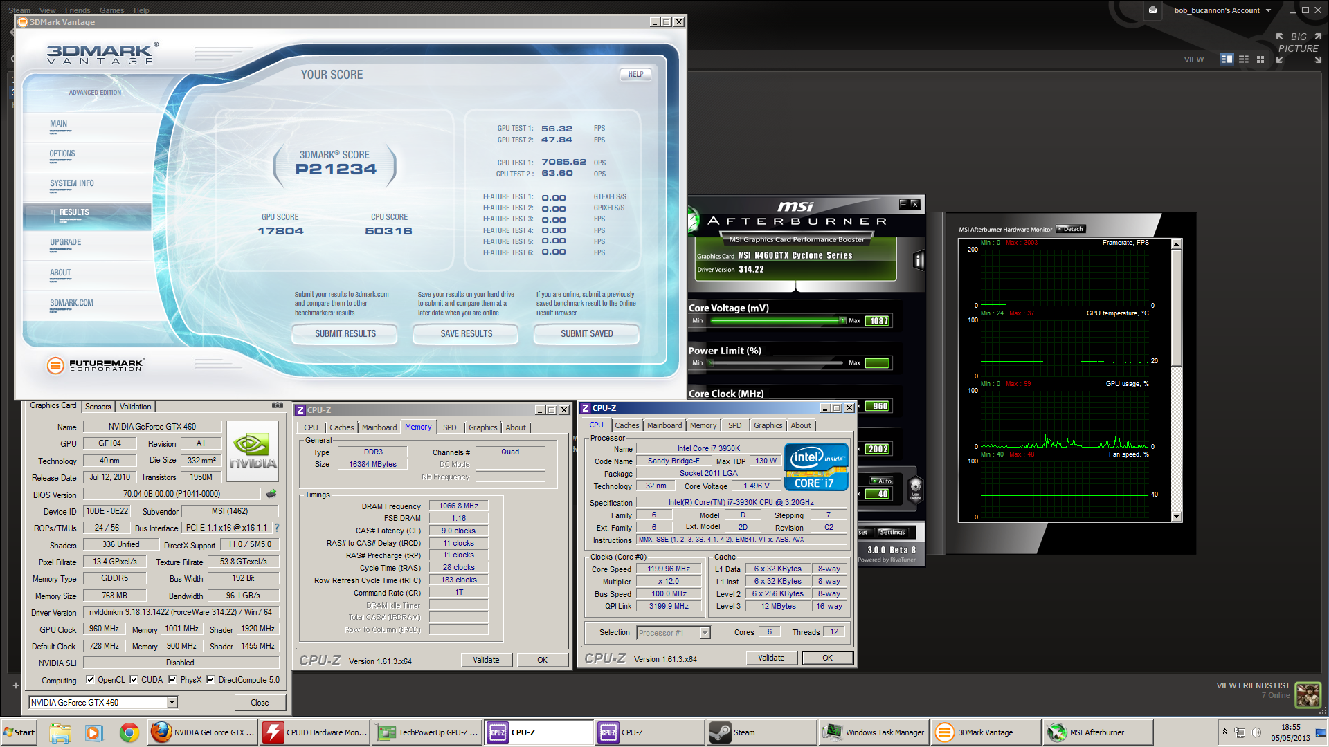

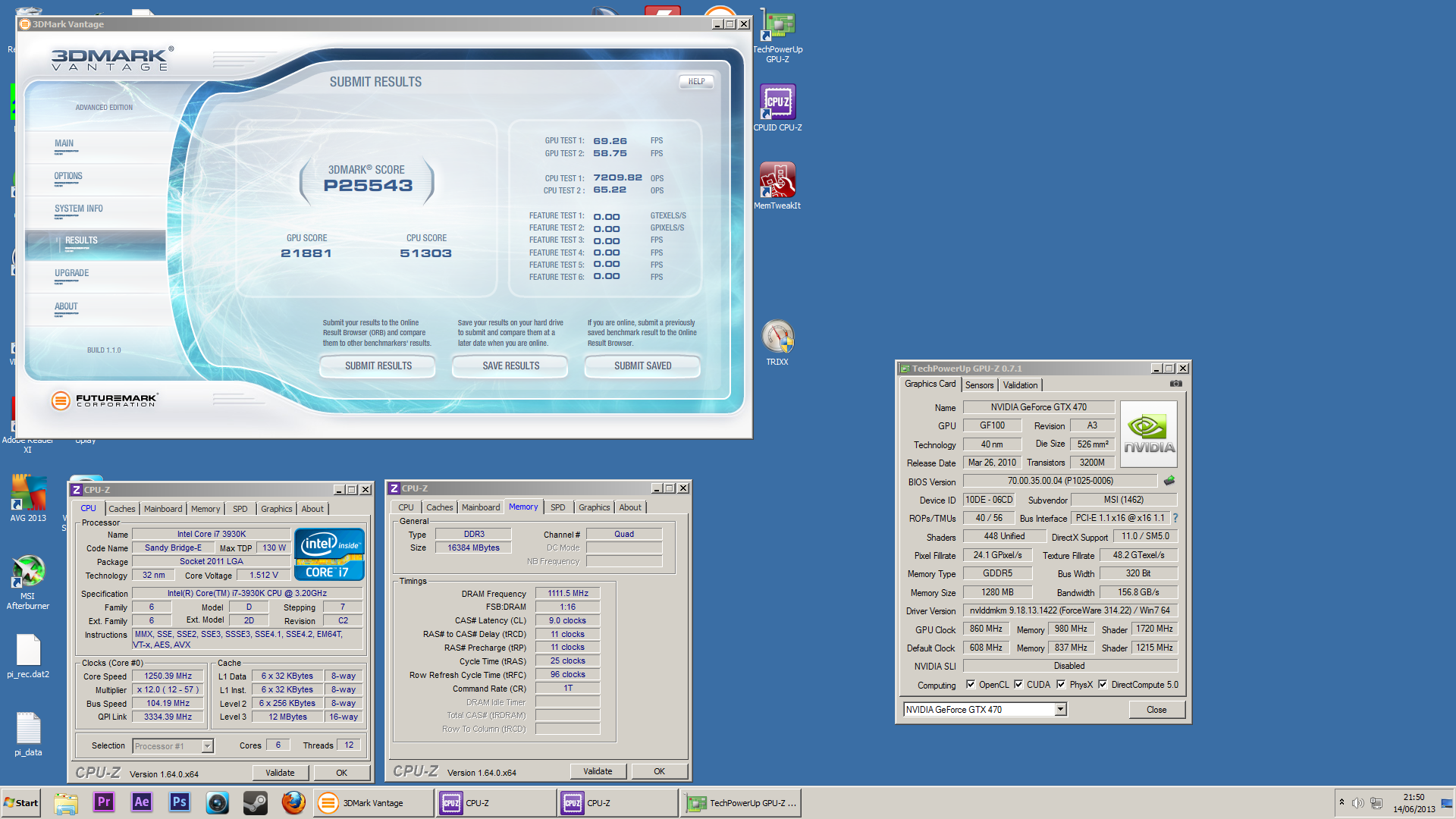

Just to show you even with a much higher core clock on the 460, it's massively outperformed by the 470.
470 @860/980
460 @960/1001
