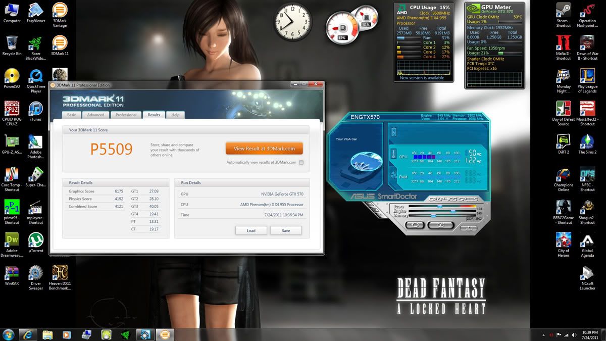

Anyway just ran 3Dmark11 through on performance settings and got this:

That's an amazing overclock in my standards!

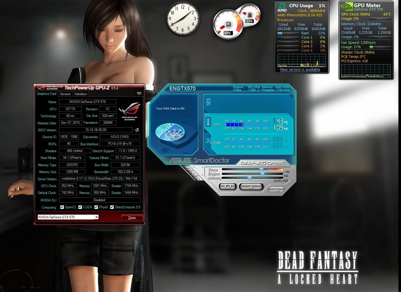

Just got my memory clock upto 4002 with 852/1704 Core/Shader clock on 1.042v
Happy with this for now, no need for a 900 core until it struggles in games.
