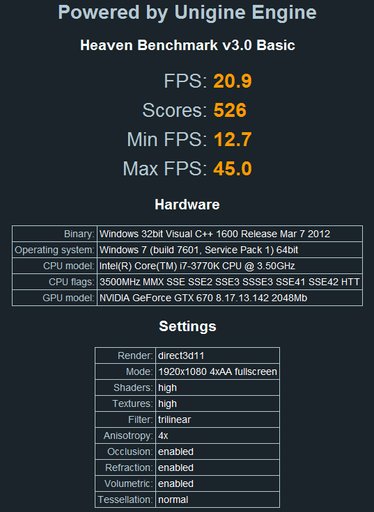

Here is a heaven screenshot:
This is about 4 times worse than everyone else with 670 is getting. Funny enough, the card is not even overclocked, if I try to boost the core by even small 10 mhz - it crashes the bench instantly.
