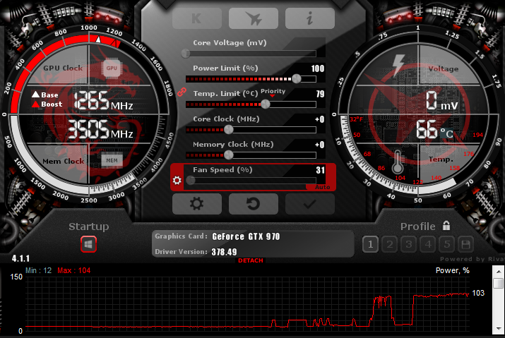

Just noticed power 107.18% would this be a problem? and is there a program that will 'capture' the HW info just before PC cuts out?

I think afterburner can log everything. Never tried it but a quick google suggests it can. I am not sure on the power %. Afterburner is a much better program for this and shows you actual voltage readouts.

What else can I use instead of Furmark? (MUST BE FREE) I don't have any loyalty to furmark its just easy to use and free and ATI Tool is no longer an option for me as it causes bad coil whine
another thing I wanted to ask is what actually causes the power cut out, is it some kind of over-voltage protection the Corsair PSU has if the card draws too much power? and can this damage the PSU/GPU at all?
As above. Download heaven benchmark and check clocks and temps. Do you have another system to try the card in to rule out power supply or driver issue, like a friends system for example? It has nothing to do with using a specific type of AA and everything to do with the fault only occurs when the card is getting pushed harder due to the higher level of AA you are introducing.
Also, does the pc actually restart or do you just get a black screen for a few seconds then straight back into windows. The second would suggest a driver crash which would probably be solved by adding a touch more voltage or lowering boost clock depending on Temps.
