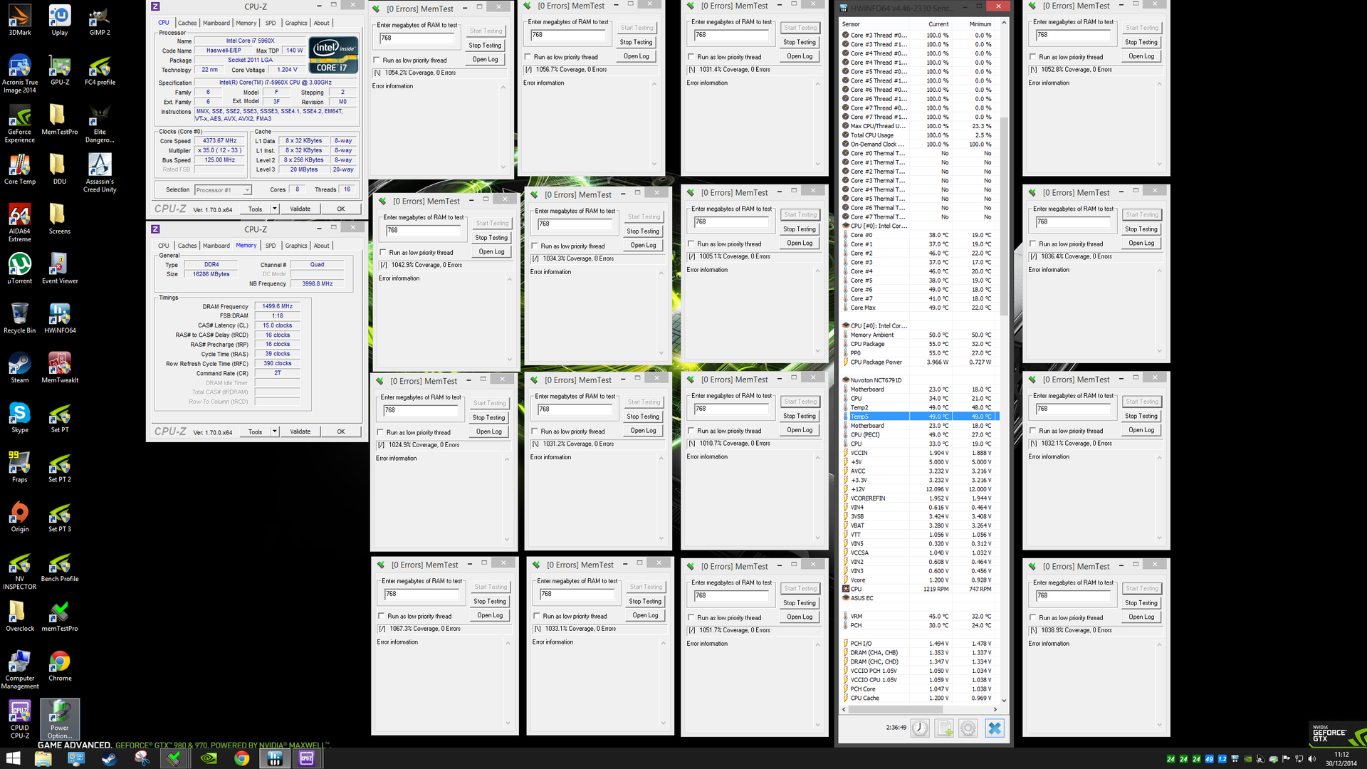

I recommend HCI Memtest pro, which costs 5$. In order to correctly load up the memory bus you will need to run one instance per thread, not core. Loading up one per core is O.K, but you are not loading up the memory entirely. Loading up 16 instances is a brutal test of memory stability, but it's up to you. Once more it is workload dependant! You can feel free to use the machine for your daily tasks, it's personal preference.
You want to be using 85% of memory leaving enough for the OS and overheads. Should look something like below. Leave for a minimum of 200%. 400-600% optimally and 1000% is classed as the 'golden standard'. 400% should be more than adequate. This test can also flag any cache instability.
