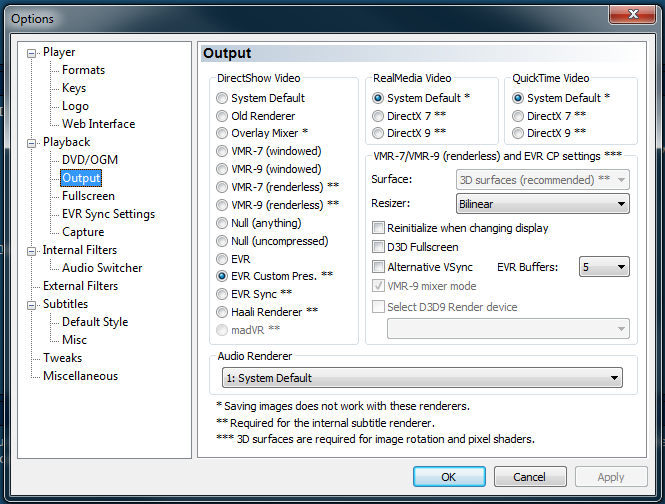

With MPC-HC you shouldn't need any additional codecs as you need to use hardware acceleration to play the 1080p files. MPC-HC comes with drivers that enable video acceleration (you should see DXVA in the status bar). Can't remember what renderer you need to select to enable them if it doesn't work out of the box though.
I suppose you mean this?
