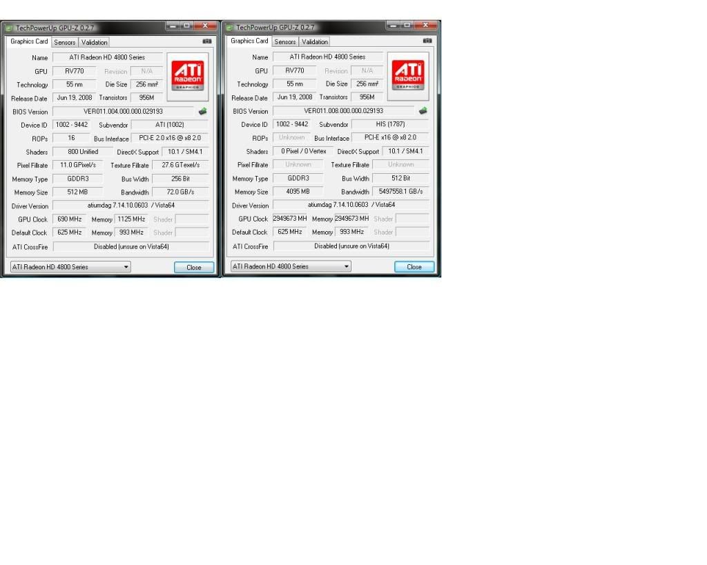

Just recieved my 2nd 4850 but im unsure as to what has to be done with drivers etc . .
do i have to get a CF driver?Or will my current 8.8 drivers notice i have CF setup ?

Can you not see a CrossfireX tab at the bottom in Catalyst Control Centre? Make sure your using Advanced view (which you most likely are anyway).
If you can't get it to work by reinstalling drivers etc, try putting just the new card in and ensure its actually working. You should also try putting the old one in your second slot to ensure the 2nd PCI-E slot is working (it should work the same as if its in the 1st, I might be wrong though).

There is a crossfire option, I am using 8.10 and crossfire needs to be enabled in catalyst.
Do you have the latest GPU-Z MiNxYyY? Also make sure you have the latest catalyst drivers 8.10, your card is being picked up just seems to be a driver issue maybe.
