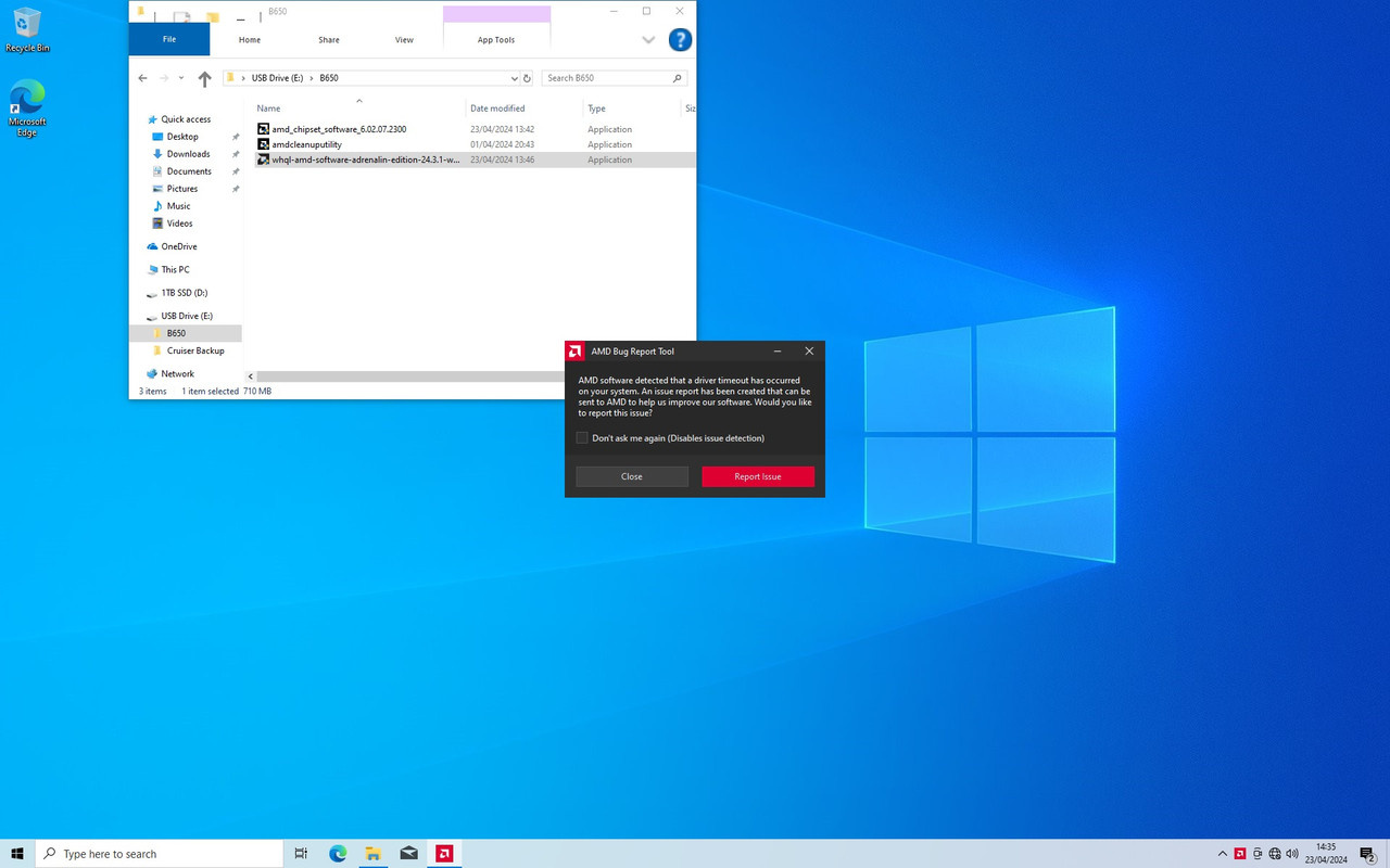

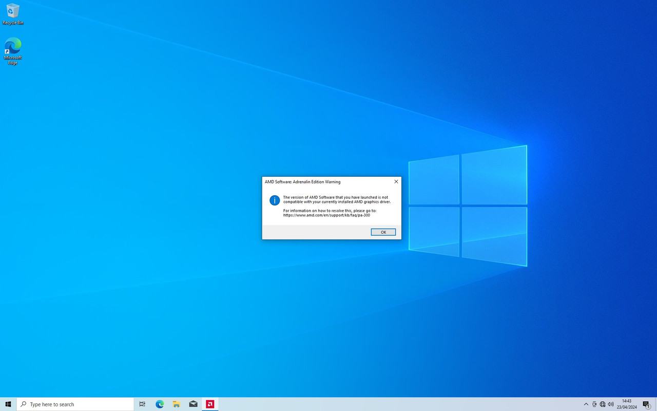

Ok, so I've been having some trouble since installing windows (10 then 11) on my new AMD build, with the the GPU drivers. On the desktop, the mouse will freeze then the screen goes black for a few seconds, then this repeats itself until I get this message "Radeon software and driver versions do not match" and "The version of AMD Radeon Software you have launched in not compatible" and/or "amd crash defender has detected an issue with your display driver. The display driver is now operating in safe mode", after which it defaults to a generic driver. I've tried various fixes, but seem to be going around in circles.
Anyway, having decided to do a fresh Windows 10 install, I'm hoping some of you seasoned AMD users out there can give me the best (least problematic) way to install drivers after the O.S is installed, and the best drivers to use (windows own, Gigabytes or AMD's).

On the desktop, the mouse will freeze then the screen goes black for a few seconds, then this repeats itself until I get this message "Radeon software and driver versions do not match" and "The version of AMD Radeon Software you have launched in not compatible" and/or "amd crash defender has detected an issue with your display driver. The display driver is now operating in safe mode", after which it defaults to a generic driver. I've tried various fixes, but seem to be going around in circles.​

I suspect what's happening is what Orcvader has suggested, that you're getting a conflict with the IGP. The driver I linked you was meant for the 7900 XT and would likely be too old to support the IGP in your CPU.
Just to wrap this up, I installed the gfx card, disabled the igpu in bios, successfully installed the latest drivers, and everything is working as it should.
Thanks guys.
Glad you got it sorted but the first thing I do is disable iGPU in BIOS before even thinking of instelling windows if the discrete card POST's ok then you're good to go leaving both can lead to other issues as well games can often pick the wrong device for example
