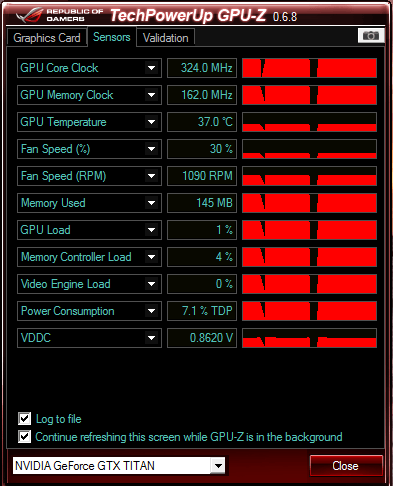

Its installed its self in "C:\Temporary\poclbm121016GeForce GTX TITANgv1w256l4.bin"
How the hell did I get this?
Any ideas how I got it?
And that virus hogs the hell out of your GPU :@
I am doing the reinstall of windows with only my SSD connected see if everything is safe.
