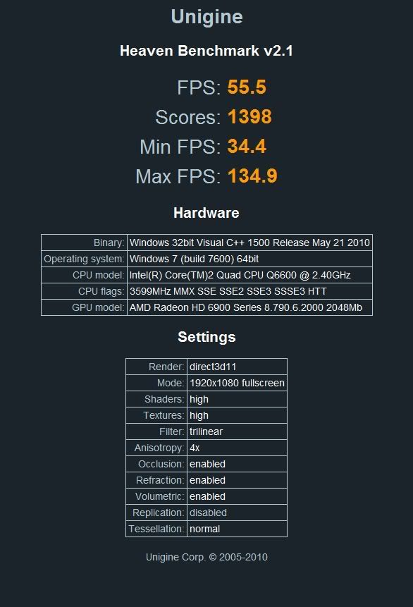

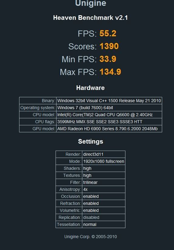

ok here are the single benches, by the way jc2 runs better now on crossfire but still its not working right because its better on a single card.
benches are at stock 6970 clocks(well one card is running the 890core asus bios other at 880 standard 6970 bios)
880
890
so both cards seem fine and the 880 card runs jc2 better on its own, will check the other on its own with jc2 now.
ok jc2 benchmark more or less identical with the other card so it seems both cards are fine, just turn crap when in crossfire. so i doubt its my processor, and the 8 lanes, well dont think its that. could it really be a power issue?
