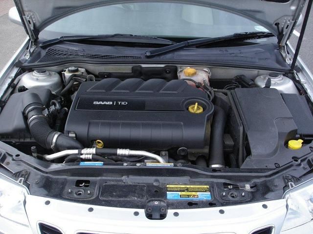

Pics of engine bay (sans plastic covers) please. Preferably a photo of the exhaust manifold side.

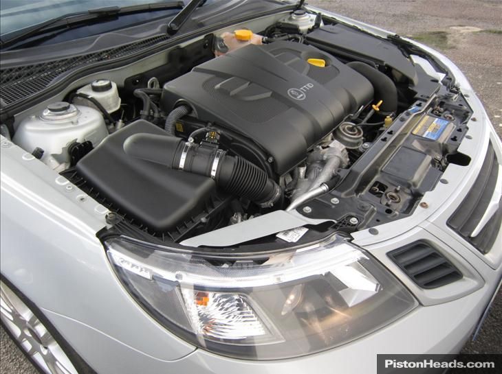

well after doing a little research, from the looks of the advert images it seems it would be a single turbo the TTID looks a lot different with different plastic cover and the top of the upper turbo wastegate actuater peeking out at the front of the engine bay.
can you get some better photos looking down the front of the enginebay between the rad and engine please?
It does seem to. The thing is, that advert isnt my car! I've found a couple which are advertised/registered as TTiD 180 but look like that.
Pics here anyway
http://i.imgur.com/UZysr.jpg
http://i.imgur.com/MSj4W.jpg

image of a Saab 9-3 1.9 TID VECTOR SPORT [150]
Saab 9-3 1.9 TTiD 180 Vector Sport

Don't suppose you can see any markings indicating an engine code?
Googling suggests a TTiD should be a Z19DTR, whereas a TiD 150 would be Z19DTH.
Couldnt see anything obvious, no
Physically, it looks identical to the 150 engine, the pictures of most 180s show a turbo actuator clearly at the top of the engine. So the badging and engine itself seems to suggest it's a 150.

pretty sure its a single turbo 150, the reason you cant see the turbo is its located under the heatshield at the front/centre of the engine.

Looking at your photos I can't see how it can be anything other than the 150 engine, the second turbo sits in the gap that is above the heatsheild in your photo.

Well, a few more nails in the coffin - notably the EGR valve being different and the lack of twin exhausts. Need to get down to Saab to clarify in the morning, but if we assume it is in fact a 150, I'm torn about what to do.
