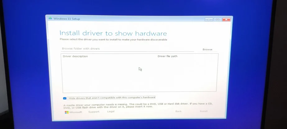

So far I've tried Fedora Media Writer - This looked like it worked just fine but I can't boot from it. Then I tried BalenaEtcher - This gives me a warning before flashing that the media does not contain a partition table and sure enough it's not bootable. Then I tried Ventoy which was fun because I learned how to extract a tar.gz and run a .sh file from terminal. This was promising. Popped the iso onto the USB drive and it booted. Selected wimboot and bam, here we go. Woohoo! Success ... NOT!
Why? I can't get passed this screen.

IRS, intel rapid storage drivers maybe ? .. download them and pop them on a usb stick and browse to the files , or see if you can disable it in the bios. IRS or VMD controller etc.

As above, this is to do with the type of drive installing too, possibly need the right storage driver. Difficult to say without knowing drive.

The partition table shouldn't affect the visibility of the drive, though. You should at least see the drive and be able to delete the existing partition(s) as GPT and MBR can coexist just fine.
@op you can enter command prompt using Shift-F10 during Windows setup, then run diskpart and list disk to see if any drives are detected. If the list is blank, then you're short of a driver. You can find the driver required and slipstream it into the install, manually copy it to the USB, or connect another external device and install it that way.

I've done shift-F10 diskpart and list disk which is showing me Disk 0 online 238GB and Disk 1 online 58GB (this is obv my USB drive)
So it can see the drives.
