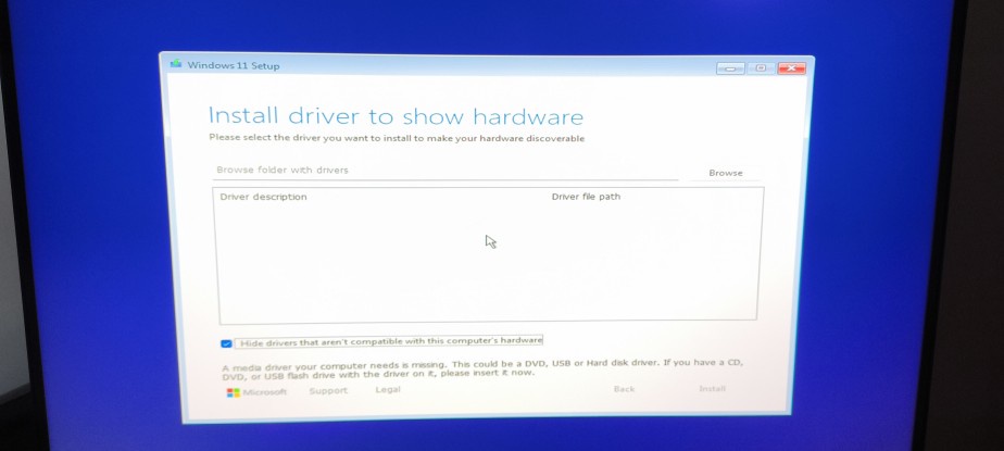

So far I've tried Fedora Media Writer - This looked like it worked just fine but I can't boot from it. Then I tried BalenaEtcher - This gives me a warning before flashing that the media does not contain a partition table and sure enough it's not bootable. Then I tried Ventoy which was fun because I learned how to extract a tar.gz and run a .sh file from terminal. This was promising. Popped the iso onto the USB drive and it booted. Selected wimboot and bam, here we go. Woohoo! Success ... NOT!
Why? I can't get passed this screen.

IRS, intel rapid storage drivers maybe ? .. download them and pop them on a usb stick and browse to the files , or see if you can disable it in the bios. IRS or VMD controller etc.
Funnily enough I've had this before too, usually when I've created a Windows disc via rpi-imager or even dropping the iso into Ventoy.
I usually have a Windows VM I fail back on to create the iso using Rufus.
As above, this is to do with the type of drive installing too, possibly need the right storage driver. Difficult to say without knowing drive.

The partition table shouldn't affect the visibility of the drive, though. You should at least see the drive and be able to delete the existing partition(s) as GPT and MBR can coexist just fine.
@op you can enter command prompt using Shift-F10 during Windows setup, then run diskpart and list disk to see if any drives are detected. If the list is blank, then you're short of a driver. You can find the driver required and slipstream it into the install, manually copy it to the USB, or connect another external device and install it that way.
Thanks lads. I'm back at it again with Ventoy since it got me the furthest.
I've done shift-F10 diskpart and list disk which is showing me Disk 0 online 238GB and Disk 1 online 58GB (this is obv my USB drive)
So it can see the drives.

Yep, did you by any chance use BalenaEtcher? As that caused me the same exact issue, regardless of me using it on Windows, Mac or Linux - it was rubbish for making Windows installers, and often cocked up Linux too and caused the aforementioned issue!
Many hours were wasted because of that app!
Yeah, just bite the bullet and borrow someones Windows PC and use Rufus, it never fails, and will grant you some bonus options just before you start making the USB ;) such as removing the requirement for TPM/Secureboot/Online account, etc etc :) So it's worth it.
I just keep a USB drive spare with a Rufus Windows installer in a draw :) It's worth buying any cheap USB stick to save yourself future hassle!
Yup, BalenaEtcher, Fedora Media Writer and the one which comes with Mint, Image writer I think it's called.
At least BalenaEtcher said to me "This probably wont work" so I give it that.
Ventoy at least got me as far as the screen above.
I knew it!
Yeah FMW gave me the same issues, as did Mint's! The TLDR is, all 3 claim that they can do it, but infact cant.
