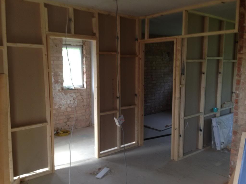

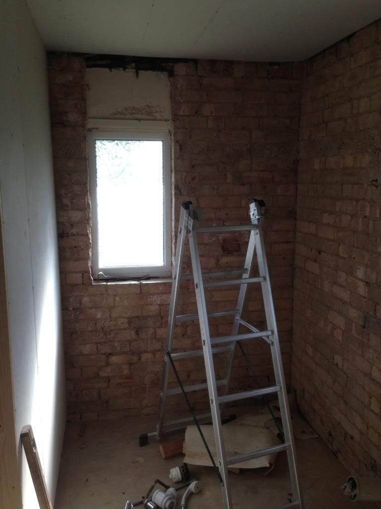

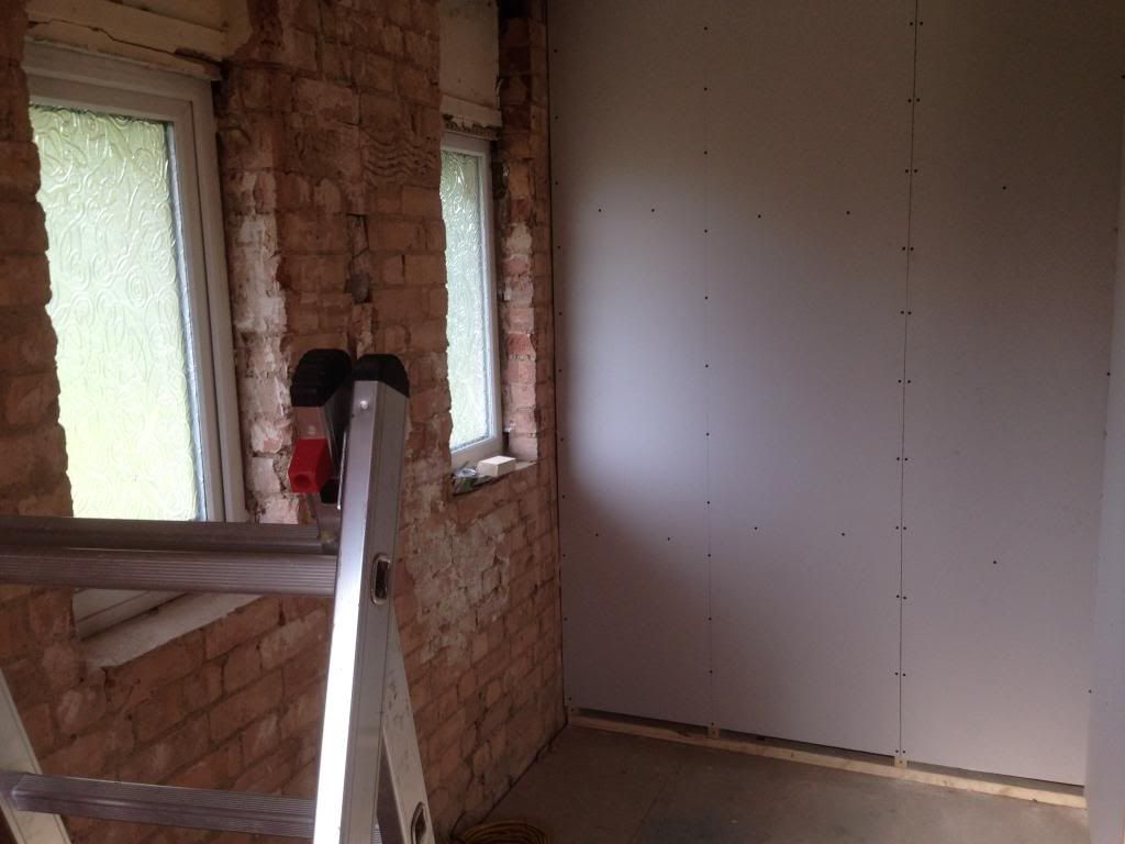

Evening chaps, I'm part way through renovating my first house... Bitten off far more than I can chew but I've got to carry on... (see sig)
I decided to focus on getting 1 room done at a time. Bathroom first.
Here's a technical drawing for your perusal...
I've pencilled in grey our intended plan...
We haven't ruled out replacing the shower with a bath/shower and using the space where the bath is for storage (towels etc)
We're open to suggestions!
Also, the flooring is 18mm structural ply. The ceiling and walls (once I've dot n dabbed the boards up) are all 12.5mm square edge plasterboards.
Can I tile straight onto the surfaces I have or do I need to treat them or something first?
Thoughts and help hugely appreciated!
Aqua panel is a purely cement board iirc.
It is strong and waterproof but doesn't have an insulation layer.
Ah right ok.
I'll see what my local TP/BnQ have got in :)
What about the flooring? Tile straight onto the boards? The only join that is in the floor space I have reinforced with noggins...
You should be ok tiling the floor if its structural ply.
Would be best priming it first, but that just helps to stop the adhesive going off quick and gives you time for minor adjustments.
Use a flexible adhesive and grout when tiling on wood.
