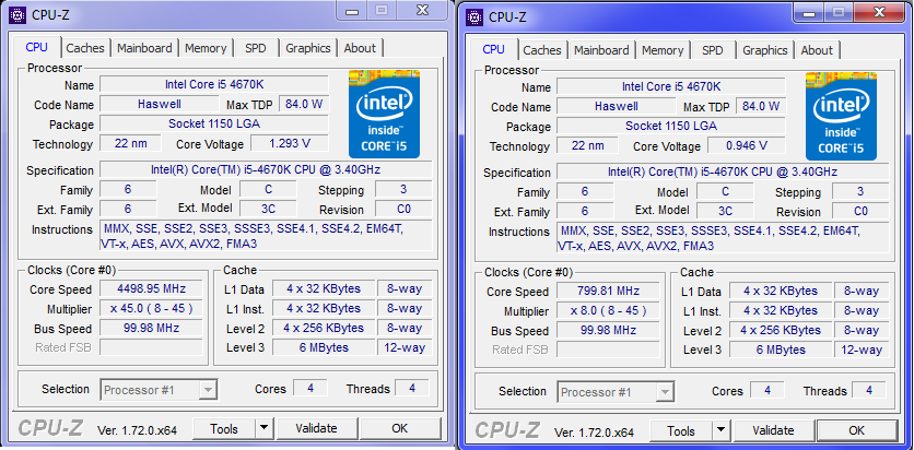

Idle
Cinebench
So now I need to change the offset to the difference between my normal value and the 1.332? I think. Also my temps were at highs of 84 during that test.
Its high as you are using more voltage than you need.
Did you add any offset to that last CPU-Z screen? if so what value?
It wont be the difference between 0.971v and 1.332V as the 0.971V value is the idle value (speedstep).
You just want to know what it is at 3.4Ghz/stock.
0.215 is what I changed it to last time as at 3.4ghz it is at 1.051v so I added the 0.215 so that it would go to the 1.269 it was using earlier. I am going along the right lines here aren't I? Or do I have it all wrong

But as you can see its too high so set it to 0.175 which should take it just under 1.3V.
78 was highest temp when on Cinebench that time. I used the offset of 0.175 for this test.

I upped it to 4.6 and ran cinebench and it blue screened. So I guess I up the offset a little bit? Or does this mean I will only be to get it working at 4.5
Everything I tried at 4.6ghz ended up in Blue screens. So I guess I need to change other options to get that working. But I am back on 4.5ghz with an offset of 0.174 with a temp of 74. I tried 0.173 and for some reason I had a temp of 80 with that so I stuck with the 0.174.
My score in Cinebench has went from the very first time using it at 551 to 649 so I guess thats the performance change.
This is from the last test I done
I guess I have found my 'sweet spot' or atleast my sweet spot for 4.5ghz. Not sure if I am able to push it to 4.6 and beyond but I have no idea what else I should be changing to do so, so 4.5ghz will have to be enough :)
