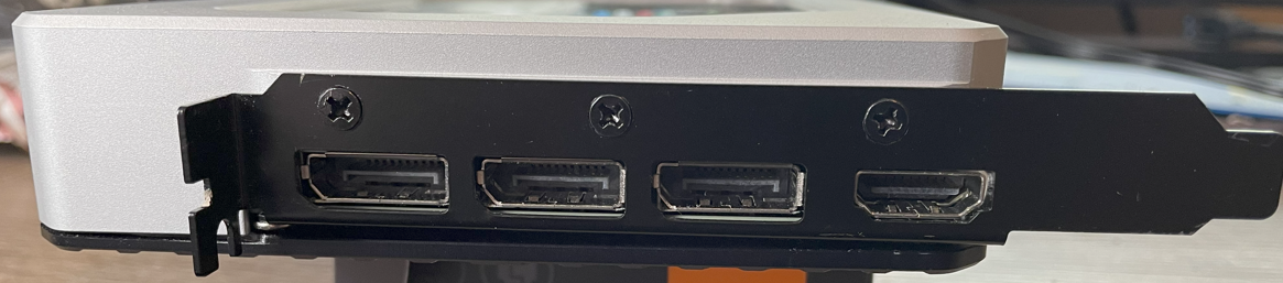

My block as not yet come but I’m noticing they look a bit chunky because of the 12 pin power plug..
Can anyone was a block please confirm that one’s fitted dose it make the card a 2 pci slot card or is it a little finer?
That’s good. It just in the photos I can find a side on **** there all from the top down angle and it looks like a 2 slot and some look like more.
I only have 2 slots the the rad fans
I had a corsair block on a 3090FE. I seem to remember that the backplate was 2 slots the rest was one and a smidge. Even with the vertical 12 pin it would fit in a 2 slot space without issue.
I’m going to be running a cpu and gpu loop with a 240mm and 280mm rad. I’m hoping my silent fans can keep me gaming silent.
Cpu is under volted and in eco mode and I will under volt the gpu too
I’ve ordered the alphacool. It will be hear tomorrow. The EK block looks to be 2 slots that’s why I was concerned
EKWB FE block is ~ 1.5 slot. Alphacool is about the same maybe thicker.
Just need to make sure whatever block provides a new i/o bracket to replace the stock triple slot.
That’s grate as long as it less then 2 it’s all good.
Block comes with a 2 slot pci bracket
