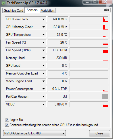

Well atm with my 780 not under load, its 31'c :)
Under load it reaches around 60-65'c.
