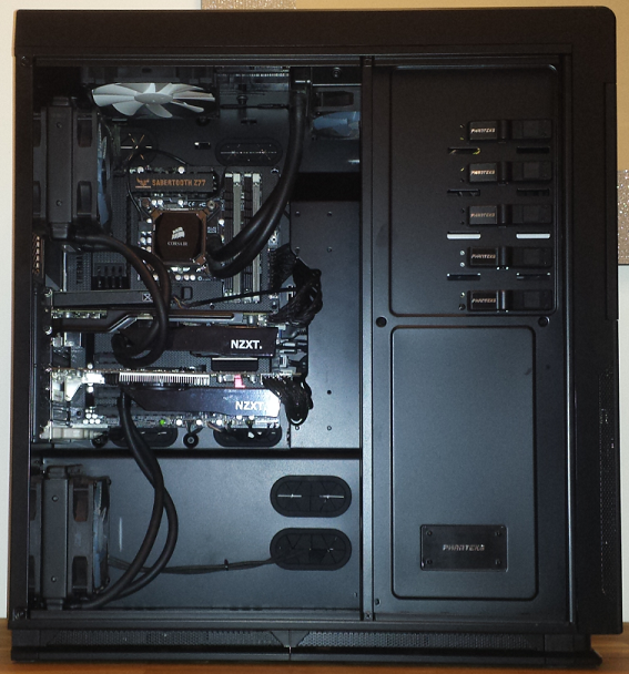

the corsair bracket wasn't around when i had my set-up, but i think it is a better option than the g10.
picture of how mine was set-up.
I was very pleased with the performance of it, very quiet & temps were on average 20c cooler than when on stock cooler.

I actually have exactly the setup you're looking to get - a pair of 290s, both with HG10s and H55s.
How many slots do you have between your cards? If you can squeeze in a PCI exhaust fan, then I'd recommend it.

I meant more like this:
It will help get rid of heat that would otherwise gather around the graphics cards. I found there was a rather hot packet of air gathering in the corner there before I installed the PCI exhaust fan.

If thats how far apart they are then its going to be a bit of a struggle to get a Kraken to fit (just look at Robzere31 pic) no way would you get a Kraken to fit s for the HG 10 to fit its going to be tight and the pipes would probably stop you.
Bottom card no problem if you have the space.
Don't know if it's possible on 2 slot jobs with an aio though due to the pipes, even if you don't use a G10.
If you look at the top 290X, the pipes don't go any flusher against the gpu, they would push down onto the top of gpu 2.
