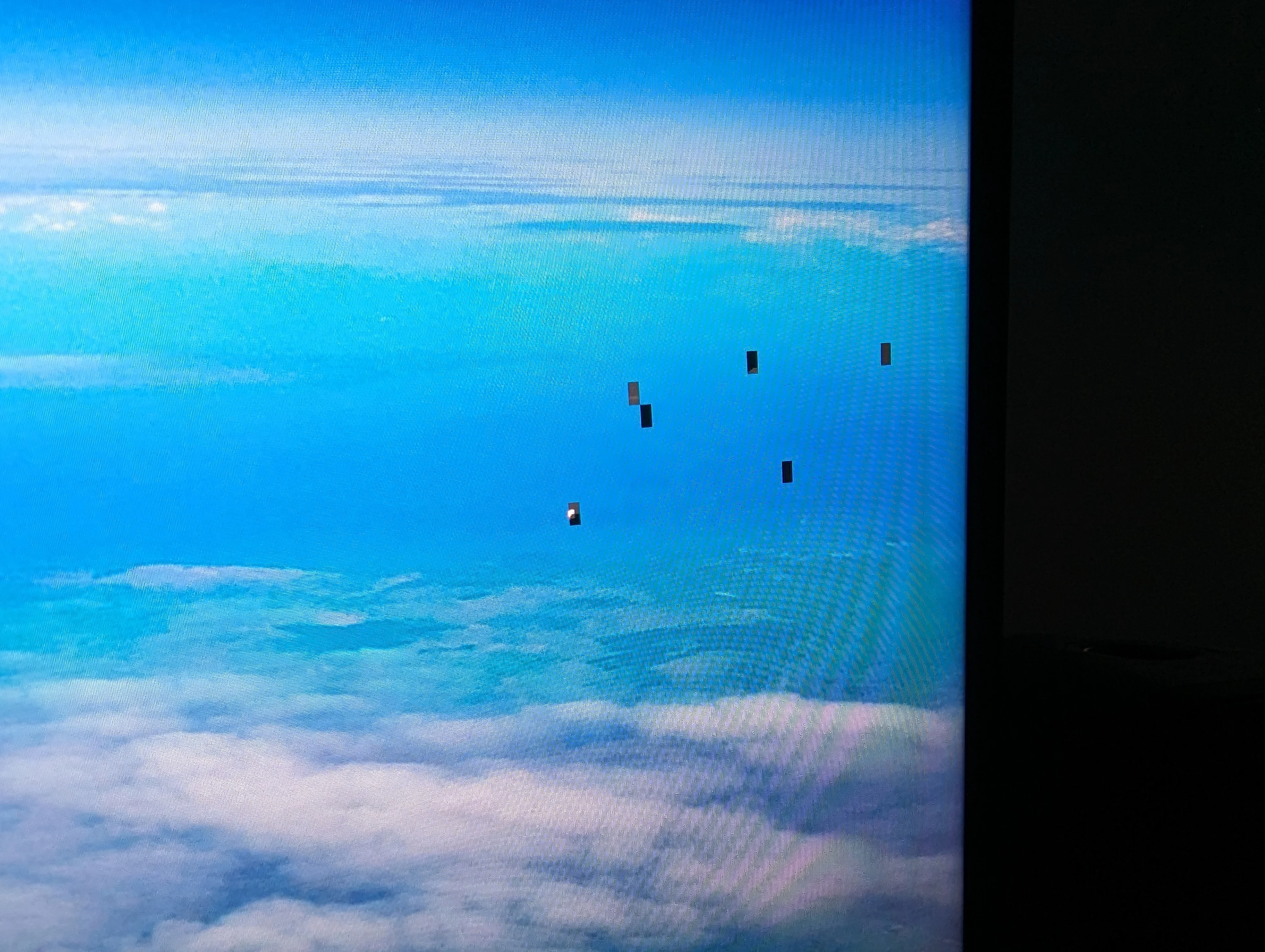

Looking for some help, Just had the below happen to me for the first time. Shorlty after the I took the below images my system restarted itself. Looking at event viewer I got the following log "The computer has rebooted from a bugcheck. The bugcheck was: 0x00000119 (0x0000000000000002, 0xffffffffc000000d, 0xffffbf0a5d99f920, 0xffff960ebbf5d3d0). A dump was saved in: C:\Windows\Minidumps\080123-8046-01.dmp. Report Id: f31265d1-7d0b-4031-b257-4b0b2e56ef14."
I'm also seeing logs for a GPUID 400 error but with a missing message. I was only browsing at the time so under no stress. Anyone able to point me to diagnose the issue or what I can do health check wise.
I started getting blocks like that after updating to the latest Nvidia driver, but never had a crash or restart.
Rolled back to the driver i had before (531.61) and all is well again. Games/benchmarks/general use, all back to normal.
119 is a video scheduler error. I have had a few. It's an OS issue, but in my case I believe that it was related to GPU undervolting. I have had no problems since I gave up on that and went back to the default profile.
Restart might be coincidental
But got similar weird black blocks last night
Either f5 /restart explorer
Or restarting the pc they went away
May try nvidia driver rollback
If happens again
I have had this before when connecting a new 144hz monitor with a HDMI cable.
At 60Hz it would work fine, but anything higher would cause weird blocking and instability.
The fix for me was changing to a Display Port cable
