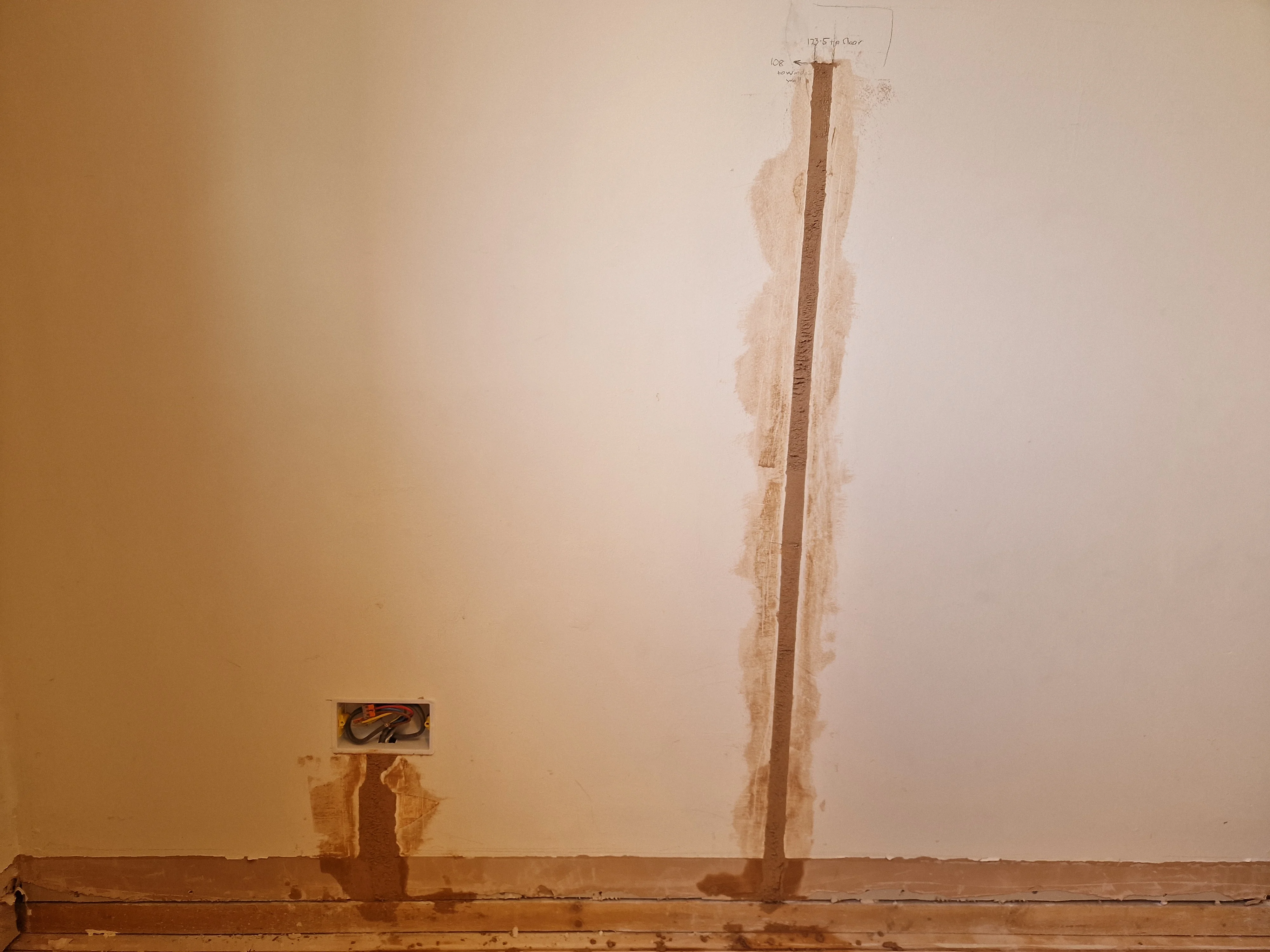

I think I'll bury conduit and mark the end of it. The cable can be run with some slack under the floor and it doesn't need to be connected (ie. Made live). Until I want the socket on the wall
sorted.
buried conduit in wall
left slack under the floorboards
spurred off the socket to the left, which has only just been added and hadn't ben properly filled and sanded yet anyway.
Then wacked in some bonding plaster I found dated 2023 :D
Bit late to see this, you've done a tidy job, personally i would have just put a socket in and until you want / need to use it just covered it over with a picture hanging / poster etc.
