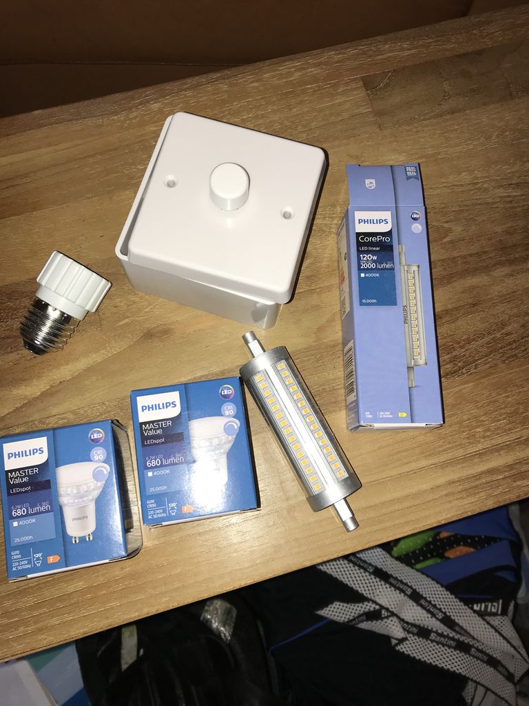

motivated me to pull finger out - will try out these £5/shot cri90 gu10s with varilight dimmer and also,
finally convert uplighter (only 2K lumens and not cri90 but, mftrs edicted we save the planet)

even the cri90's i bought, above you can feel the difference in the kitchen, am experimenting using them as a dimmable tv backlight too.
