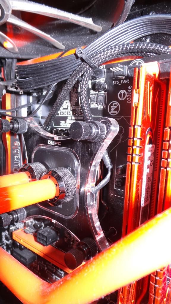

My initial thoughts after seeing your pictures where exactly as pastymuncher suggested either your block or the chips IHS was warped or even your over tightening the block. the IC24 rep was using preasure paper to test water blocks could you source some of that to see where the block is actually touching the IHS of the new chip if you still have problems.
Alternatively can you buy or borrow an alternative block to try out.
Block doesn't look warped. See below
