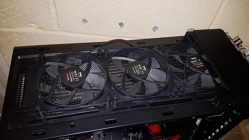

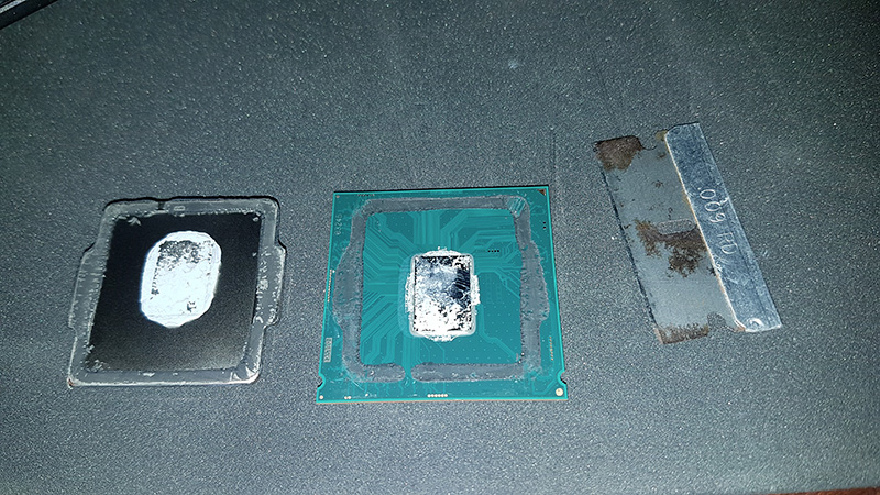

Okay! - I've made the changes, and I even went a little overboard and decided to de-lid my CPU and shove some liquid metal pro onto the die.
all and all I'm pretty happy with the results ;) my water temps are staying low, and my CPU temps are now 10c lower at idle, and up to 20c lower during gaming/benchmarking!
Here's a couple of pictures:
I switched the top fans back around to exhaust, this leaves my case with only 2 fans pumping air into the case through the front radiator. - I wasn't able to put a 3rd front fan in as my rad has been pushed upwards a little, making the fan hole too small for a 140mm fan... perhaps a 120mm fan would fit though, i'll test that out later.
so my case is now configured with 2x intake and 4x exhaust + PSU. - this won't make any differences in cooling performance, but I hope it doesn't start to get too dusty inside >.< (yes... I clean the case when it's needed.)
And here's the after picture of my scary experience with de-lidding my CPU!
Luckily the de-lid went rather smoothly, once I managed to get the blade into the corners it's just a case of rocking it back and forth to cut the seal and wedge the blade in there a little... then I took out a hammer and bashed the s*!t out of it! - no, more seriously, I did use a hammer though... some light taps when the blade was refusing to cut in, the hammer tapping method made it really easy to cut in without pushing too hard or slipping actually.
