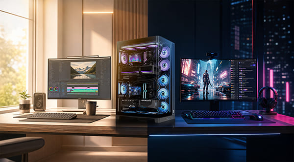

We don’t have the biggest room to share a setup so in coincidental timing, I saw the Thermaltake Capo X. A unique idea that would suit us, replace my case with something taller to accommodate 2 PCs

Any aesthetic considerations you want to keep in mind or is it less of a concern? I believe the Capo-X is a dual M-ATX fishtank type case?

shame the below case isn't out yet. Perfect for your needs

The case doesn’t seem to be coming out to Fall 2026 so gives me time to test her out before I spend
