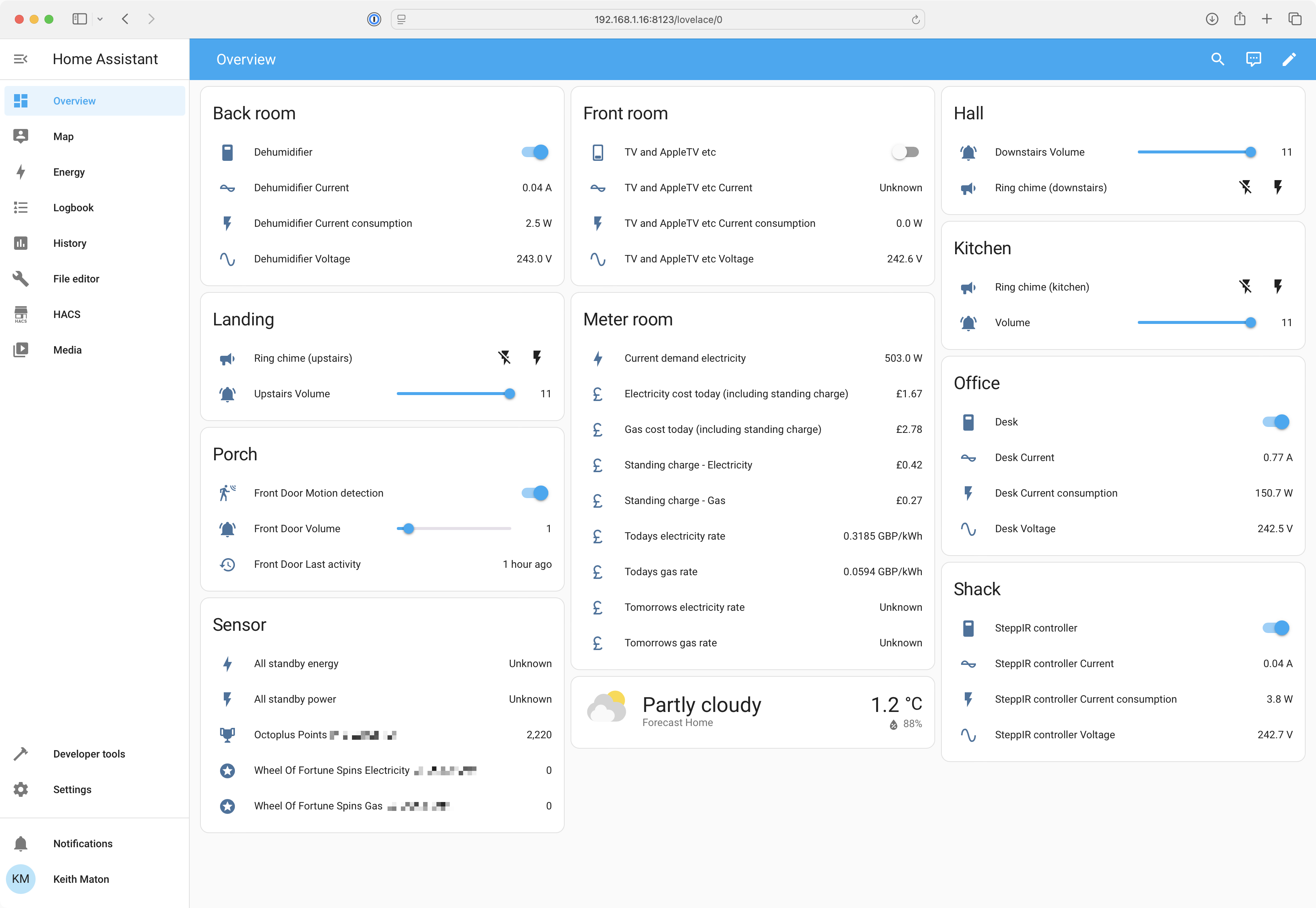

What’re you trying to do? Measure the electricity usage and cost of individual devices or your home as a whole?
Individual device tracking through the Tapo plugs I have and an overall cost with history.
I've got this so far.
I've installed the Octopus Energy Integration along with PowerCalc but I have absolutely no idea where to go from here.
I'd like to be able to see the energy usage and associated cost of each of the Tapo plugs (will be adding some more today) along with with history. So I can look back and [for example] see that my office used xx kW of electricity last Wednesday and it cost me £xx.xx.
I'd like to see the same for the entire home as well.

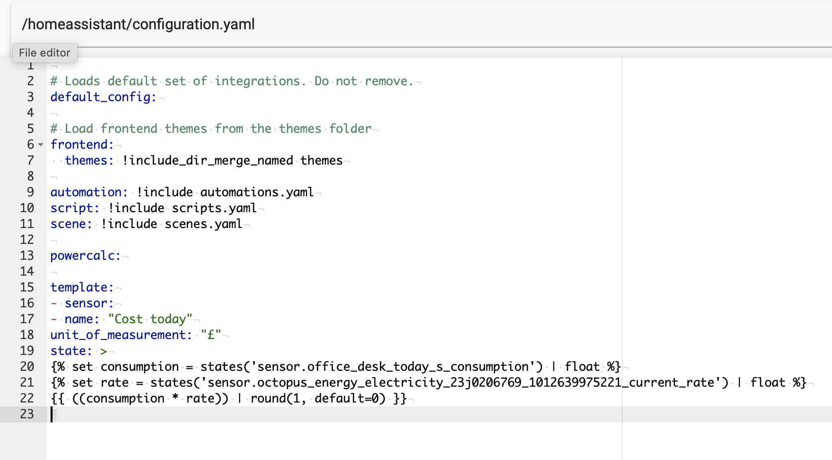

I couldn't use the file editor you suggested, it seems to crash the HA Pi - I'm only using an old 3B for this as my spare 4 is now being used elsewhere. If I can get it to do what I want, I'll use a better device.
Error loading /config/configuration.yaml: while scanning for the next token
found character '%' that cannot start any token
in "/config/configuration.yaml", line 20, column 2
I edited the two lines with what I think are the correct choices.
<snip>
Your/ Dlockers indentation hasn't translated correctly on the copy and paste. @dlockers - if you use the code insert button then the YAML should be correct and Feek can copy/ paste it right into his config file
Code:
template:
  - sensor:
      - name: "Cost today"
        unit_of_measurement: "£"
        state: >
          {% set consumption = states('sensor.garden_room_ac_today_s_consumption') | float %}
          {% set rate = states('sensor.octopus_energy_electricity_19l2262519_1012474423759_current_rate') | float %}
          {{ ((consumption * rate)) | round(1, default=0) }}
I'm not sure it is working but that could be because I am selecting the wrong sensors - the maths seems to be OK and I think the path I am following is OK though. Will troubleshoot
(I just checked and its stuck at £1)

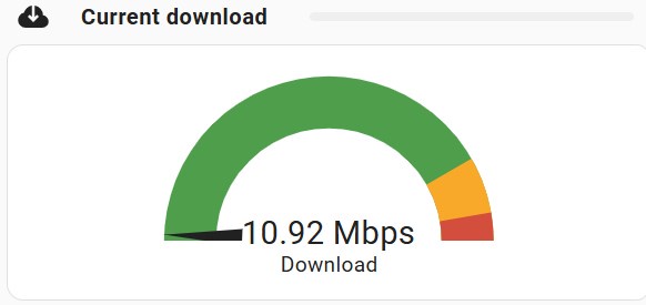

I've got a few defined in configuration.yaml:
Code:
template:
  - sensor:
      - name: "Internet Download"
        state: "{{ (states('sensor.uxg_wan_in_stats')|float(0)*8/1024/1024)|round(2) }}"
        unit_of_measurement: "Mbps"
      - name: "Internet Upload"
        state: "{{ (states('sensor.uxg_wan_out_stats')|float(0)*8/1024/1024)|round(2) }}"
I can then call those sensors elsewhere. Such as:
Code:
type: gauge
entity: sensor.internet_download
name: " Download"
min: 0
max: 900
needle: true
severity:
  green: 0
  yellow: 750
  red: 850
Which gives this:
If you're a Facebook user then then the 'Home Assistant UK Community' group is very useful. There's people there that know HA extremely well and are keen to help out.

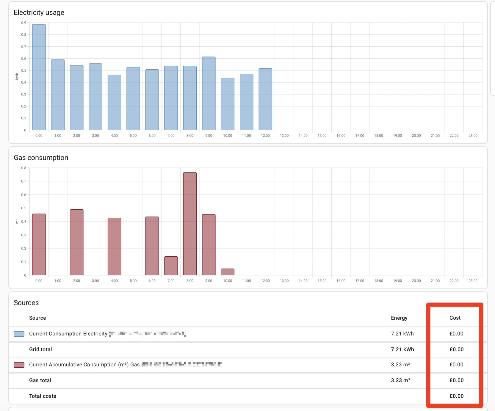

I've moved HA from an old RPi to an Intel NUC and I've sort of got the daily device consumption and cost sorted out but it will need some fettling.
In the meantime, looking at the energy tab in HA.
I've got this set for electricity.
And similar for gas.
The daily consumption figures look correct but why is the cost sitting at zero?
My overview is showing all energy stuff is calculating properly.
Answering my own question.
Gas was set to Current Accumulative rather than Current Consumption.
Prices have now started showing up after I posted - I guess it couldn't back calculate so it's only from when I set it up (at around 14:00, just before I posted above) rather than showing historical cost.
Added it through the energy configuration screen, the same way as the electricity one posted above.
