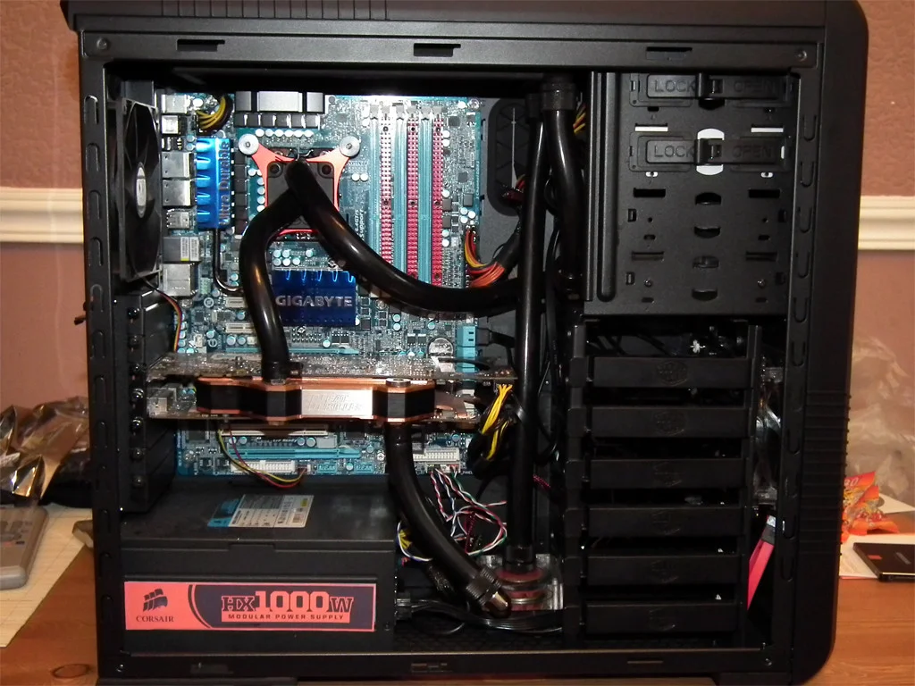

My original thoughts were to build a completely new, low power machine with loads of storage as a download/storage/media server machine. I decided that, rather than buy new hardware, I'd utilise unused gear I already had. I decided on my old gaming rig which has been retired for some time now and convert it into something I could use for my server needs.
The old gaming rig specs are:
i7 950
6GB DDR3 RAM
Gigabyte GA-X58A-UD3R
Nvidia GTX295
Corsair HX 1000W PSU
500GB HDD
Cooler Master CM-690 II Lite Windowed Gaming Tower Case
All cooled with a custom watercooling loop.
The intention is to use basically the same hardware but underclock and undervolt it and run it headless to cut down on power.

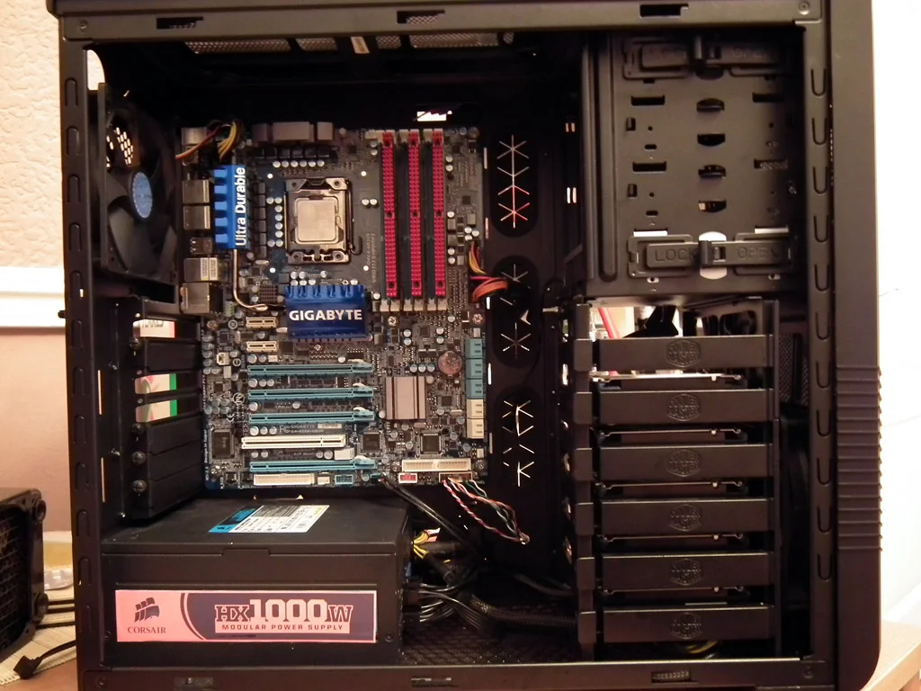

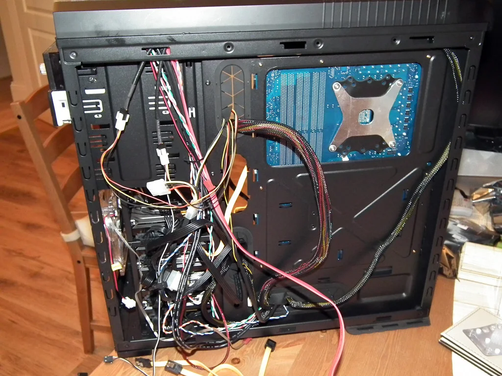

I made a start tonight but I was doing it quick and dirty and it just looked messy so I've decided to take the whole thing completely apart and start from scratch.
This is it looking messy :o :
There isn't any particular hurry with it but I do want to get it set up to the stage I can install the OS before 31st Jan - that's when Microsoft's £24.99 Windows 8 upgrade deal ends. I plan on installing the copy of Windows 7 already purchased for the gaming rig and upgrading to Windows 8 pro and using its 'Storage Spaces' I'll be installing the SSD as a system drive and 5 of the 6 Barracudas in parity mode (basically RAID5) and keeping one for replacing any drive that fails.
The machine will mainly be used for storage as well as downloading and decoding stuff (NZBs and stuff through Couchpotato etc.).
I'll post up some pics once I get it all dismantled and then update as I build it up again. I would start now but I'm rapidly approaching drunk and can't reaaly be arsed so I'll just have another dry martini and make plans for tomorrow :p

I've gone about as far as I can for now. Ordered some stuff today which should be delivered tomorrow. Namely; shorter SATA data cables to cut down on cabling clutter, a cheapo, fanless, low TDP graphics card and an Arctic Freezer 7 cooler. I decided that a 240 rad and watercooling loop was a bit overkill for an underclocked CPU. I do have a 120 rad but it's too thick to fit anywhere sensible. I decided, rather than buying a new rad, I'd be as well going for a cheap and quiet air cooling solution.
Pics of where I'm at now:
Just waiting for the cooler and GFX card:

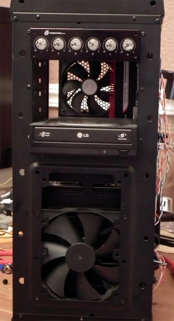

140mm fan at the front to cool HDDs, 120mm at the back for vent, fan controller to keep the noise down and DVD RW installed:

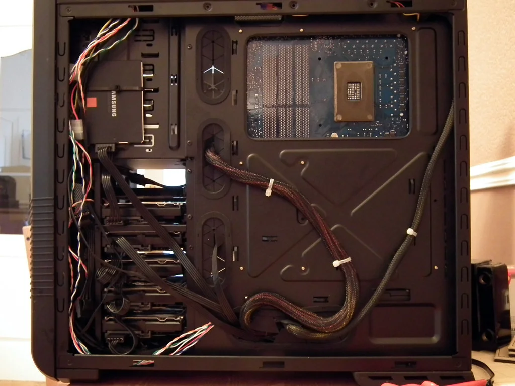

Cabling looking pretty tidy so far:

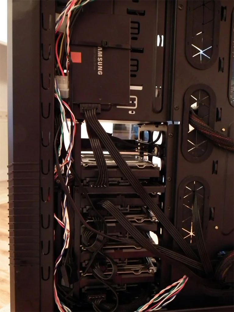

SSD and HDDs in place, waiting for data cables:
Should get it finished tomorrow when the rest of the stuff gets here, leaving me 2 days to get the OS installed and sorted out.

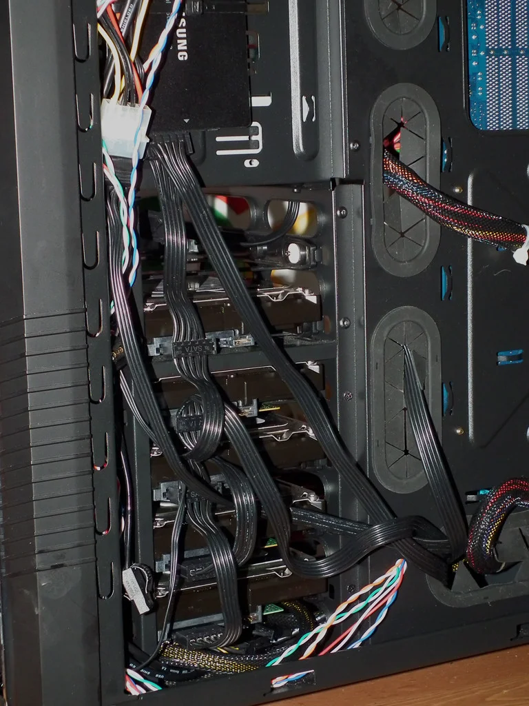

Much tidier although if I were you, I would pull of each of the sata power connectors and space them out to the distance of the drives. Makes for a much neater job and is easy to do :D
Looks a great case for home server!
Like this you mean?
Does look a bit neater right enough :)

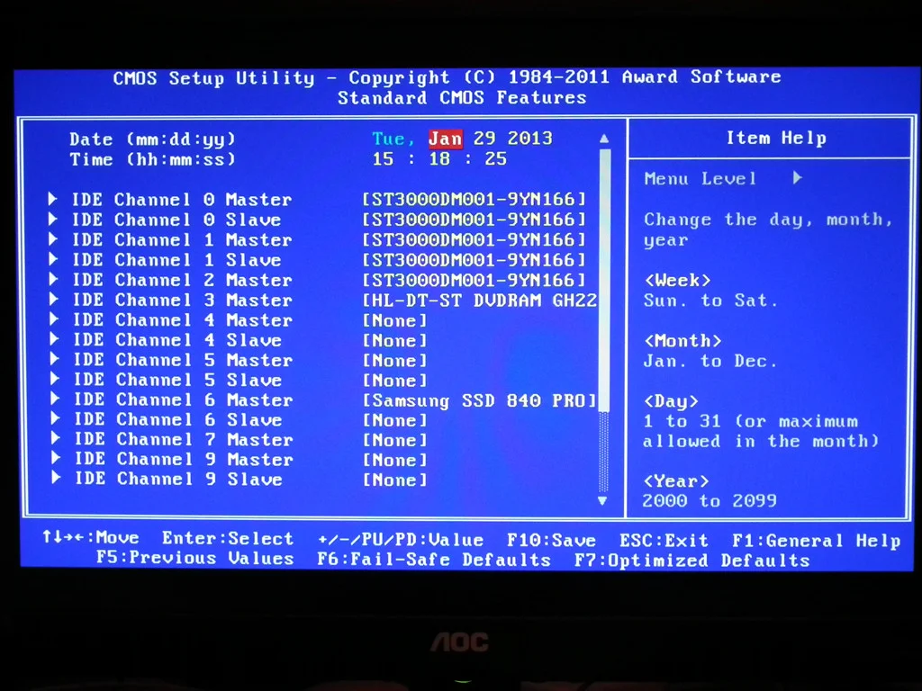

After I got the thing finished, I had the usual apprehension on first boot. "Will it boot first time?" "Have I made any schoolboy errors?" etc. No worries on that score, she booted first time and I got into the BIOS to check all the drives were working.
All was well on that front.
