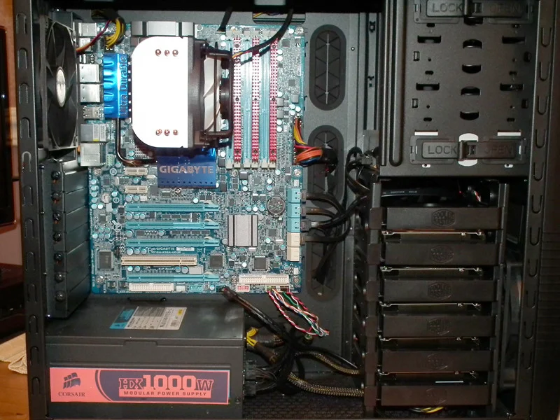

The finished article:
As tidy as I can get it without getting really fiddly. Cables are tucked away as tidy as possible to improve airflow and allow me to keep the fans turned down low since it sits in the living room.

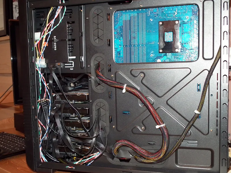

Looking tidy out the back too - definitely an improvement on before.

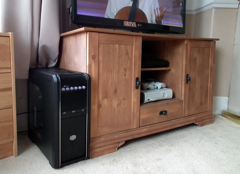

The server in situ.
