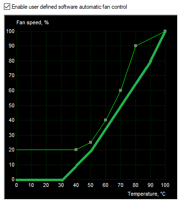

So I'm kinda new to actually having modern hardware inside my PC and am unsure if a 100 degree memory temp is right... or even if MSI Afterburner is reporting right on Navi cards?

Does anyone know if I should be ramping up my fan curve even more of if that's normal? :D
https://i.~ibb.co~/VNz0Gvg/cxvxcv.png https://i.~ibb.co~/2gZN4Rm/fgdfgd.png
The memory should only go to around 86c on the 5700 series. However Hardware Unboxed (Australian YouTube channel) recently reviewed the Asus TUF Gaming which was hitting 104c as it had a terrible heat spreader covering the memory but with no fins to dissipate heat. I don't think they have reviewed your specific Asrock model yet (they mainly reviewed the high end coolers from various manufacturer) but all the others besides the Asus TUF Gaming peaked at maximum 86c like the reference AMD cards.

I'd change it to something like that, the fan can stop when the temperatures are low. There is no need to spin all the time at 20% or more.
Ok, I'll re-wangle the curve.
