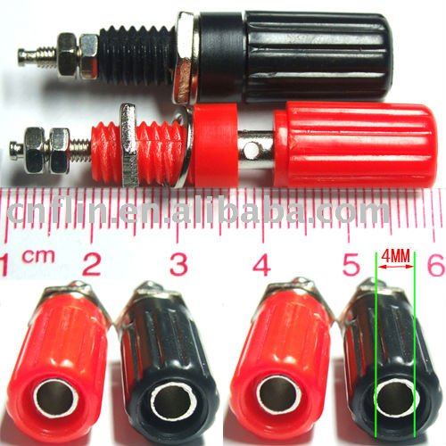

These are typical sockets for speaker connections:
This one is bare wire spring clips...
...and this is bare wire screw down terminals with 4mm banana plug holes, so they're multi-format.
This is a pair of phono/cinch/RCA connectors.
These are used to connect equipment together such as a CD player to an amp or a TV line out socket to and amplifier Aux input socket.... can ya see where I'm going with this yet? ;)
Anything correctly marked as AUX is designed NOT for connecting speaker to. It IS designed for connecting other bits of equipment to. AUX normally infers a line input connection.
