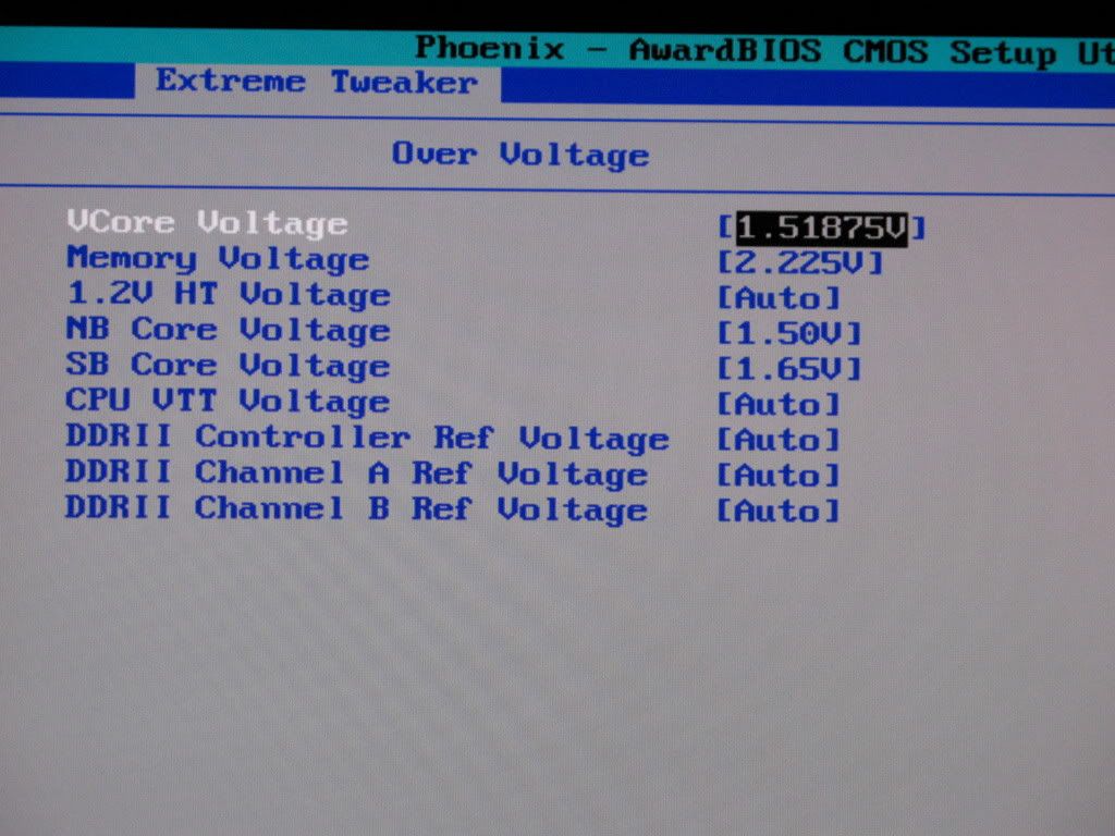

These are the voltages I have control over. Found this image via google so its not my settings.
http://i167.photobucket.com/albums/u151/Syrillian/Gemini/BIOS/8Voltages.jpg
On here I see the north bridge, vtt, but no PLL? Is PLL under a different name?

Some people prefer to put the voltages in manually, others prefer to leave them on Auto.
At least if they are in manual, you have peace of mind that you know what they are and the board isn't over volting anything.
Your thinking along the right lines that all voltages need to be the lowest for a stable overclock.
