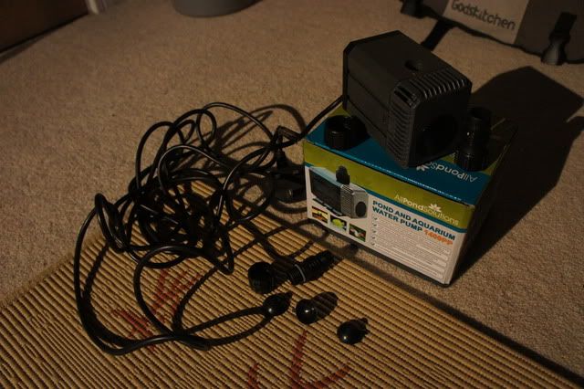

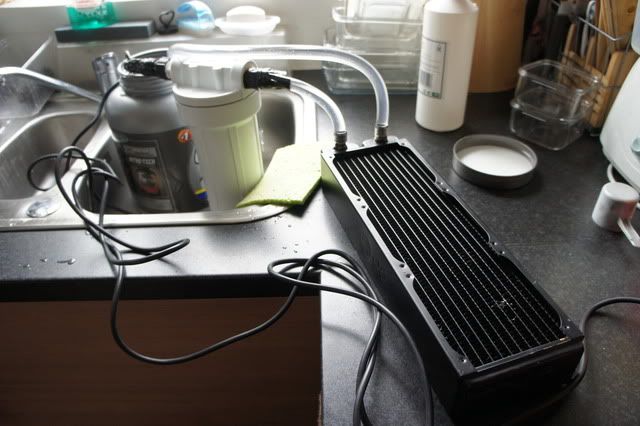

I use the following :-
A pond pump. I got mine from a local aquarium shop for £10
A bucket or container of some sort for the pond pump to go in like a used protein shake container. Acts as a resevoir for the pump

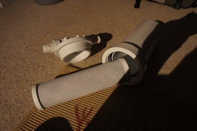

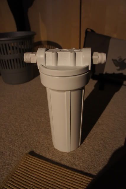

Regular house mains filter (High Capacity Water Filter)
Can be bought from your regular DIY retailer or plumb shop. I sourced mine online for around £12. Bigger retail chains sell for more but if you look around you can find one pretty cheap like mine on the interwebs.
You will also need some fittings to go on the water filter. Again these can be sourced from a garden or DIY centre/retailer for £2 a fitting. Mine are a little bigger than half inch but a little force and you can get half inch tubing on no probs. So in the picture that will replace the ptfe tape and gaffer tape going to and from the filter.
Hope this helps you guys. I swear by it, gives me peace of mind knowing that i have cleaned out the rads thoroughly. without the hassle of the old school shakey shakey

I went for res/pump - filter - radiator then back to res/pump. TBH I think the orientation of whether radiator or filter is first does not matter too much as the filter will get most of the grime out after 10 mins or so.
