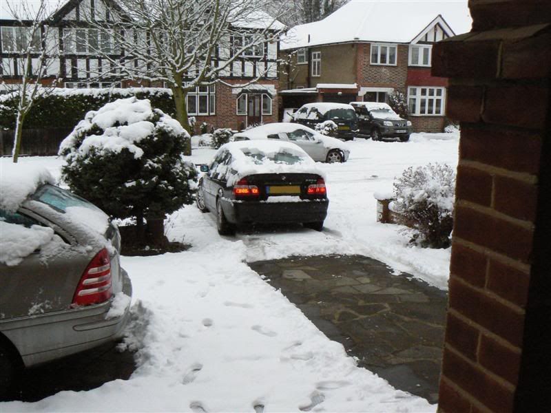

sorry but this is just wrong, a subaru can go as fast in the snow as some cars can in the dry, this obviously required a fair level of driving skill though.
That's as far as i got in the snow last winter :/
