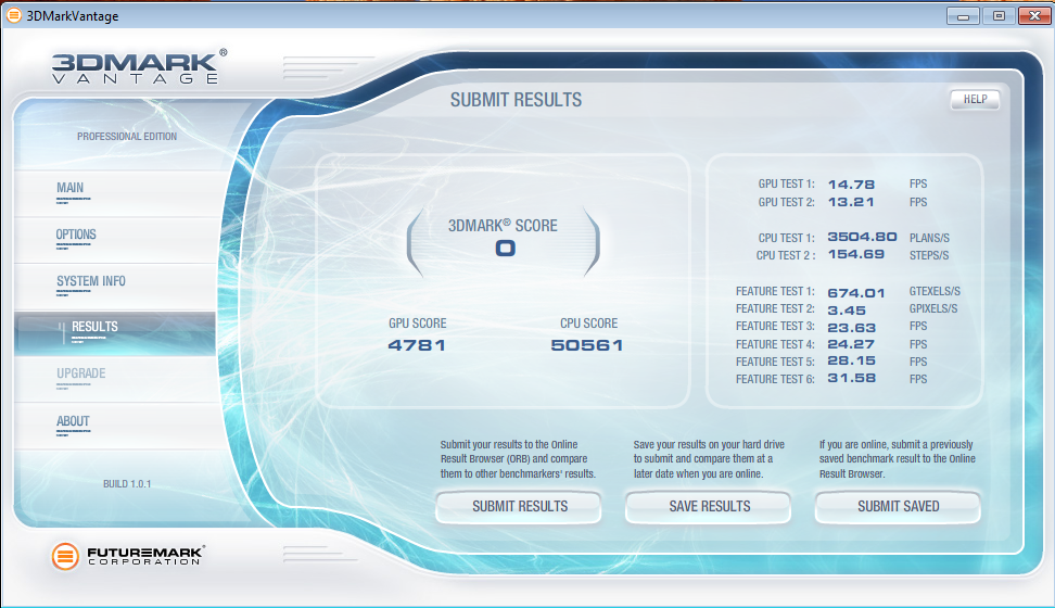

how does this compare to other i7 920's?
reason i ask is im using a x19 multiplier and others are using x20/x21 so wondered if it made a difference.
CPU Clok ratio 19x
QPI Link speed x36
Baseclock 211
Performance Enhance - standard
XMP disabled
System memory multiplyer SPD - 8.0
intel turbo boost - enabled
Cpu cores enabled - all
CPU multithreading - enabled
C1e , C3/c6/c7, thermal, EIST and PROCHOT all disabled
Virtualization - enabled.
Uncore freqency x16
Isochronous supprot - enabled
PCI frequency - 100
CIAZ -disabled
CPU clockdrive 800Mv
PIC Express clock drive 900Mc
CPU cliock skew 100ps
IOH clock skew 0ps
Local-line calibration - disabled
CPU Vcore 1.300V
QPI/VTT coltage 1.295v
IOH Core 1.16V
DRAM Voltage 1.640v
everthing else is as at default / auto
Ram : 8-8-8-20-1
Max Temp Under Load : 78
Spec : i7 920 D0 @ 4.0GHz, Arctic Freezer 7, GA-X58-UD3R, TEAM XTREEM 6GB DDR3-1866 TRI CHANNEL, 9800GTX+, Samsung SpinPoint F1 HD103UJ 1TB, Hitatchi HDT721050SLA360 500GB, Maxtor STM3500418AS 500GB, NZXT BETA Case, Windows 7 Ultimate 64 bit, 42" LCD TV
Res : 1800x1018
CPU-Z
3d mark 06
3d mark vantage
passmark
fritz chess benchmark
super pi
cinebench
any comments welcome.

However despite the large number of screen shots above, there is no sign of stability testing. As such I must conclude that it's an untested 4ghz, and as such much less interesting.

i have done plenty of stress tests with OCCT to make sure its stable, but OCCT doesnt really give anything useful at then end that i understand, just some graphs. i know its stable, as its been tested and i have been using it for what i normally do and have found no issues at all with it.

As an example, this is my system, and it was not stable in normal use with these settings even though it passed ibt.
