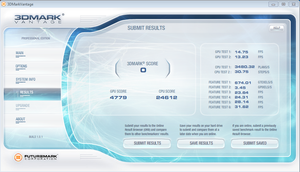

some quick results
3dmark vantage physx enabled
3dmark vantage physx disabled

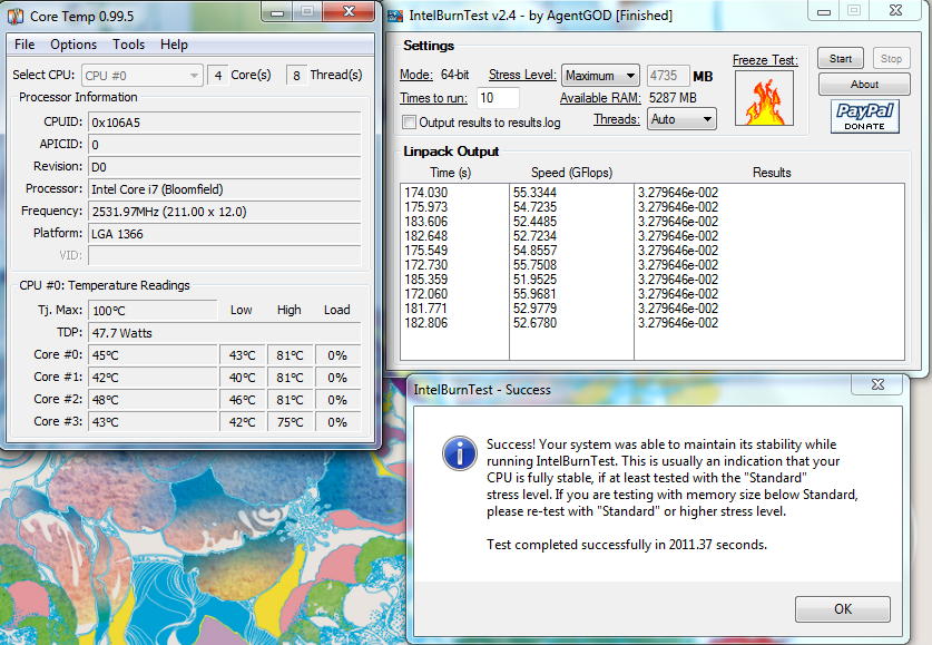

intelburn 10 cycles maximum setting (about 30mins)

Ten loops of ibt (with maximum memory used) is fairly conclusive as it's a particularly aggressive test. 30 minutes of prime by comparison doesn't mean as much. Intel burn test / linx is popular because it tends to show up instability quicker than prime does.
