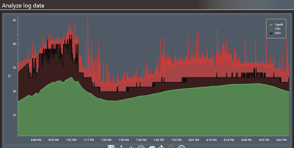

Heres some fun stats, I played WoW for a little bit tonight, the chunk between 1845 and 1903 was the wall radiator kicking out some serious heat. It's electric (America... Cheap horrible long low profile electric 'radiators') which is at the back of our desks, all that heat was being sucked into the PC raising temps a considerable amount. We also have an electric fire we leave on in the evenings at the moment which was on the entire time. The radiator was a blast to warm the place up quickly whilst the fire got up to temp. Once the heating turned off, the temps dropped and slowly started to rise as the ambient temp climbed as well.
I've set the Aquero to log ambient temps and tomorrow I will do the same test in a more demanding game over a few hours (Red Dead Redemption 2). It's interesting to see just how much the temperature of the surrounding air plays a role! Who'd a thunk it eh? Thermodynamics are real :P
