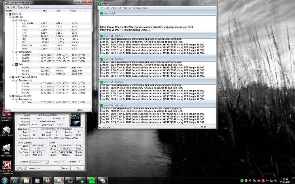

Ok so got home and installed the AMD HFS.
Idle temps were about 37/39 wit the Fan on Auto. I ran Prime95 with the results below. Case was open and ambient room temprature was mid 30s:
The HSF and fan was installed correctly using the paste that comes with it, which was as 'stock' as I could get it. To me thats way to high, given that I've removed the HSF from the equation, could this just be a dud CPU?.
Sileo 500 or HAF 922, seems irelevant if the retail fan is chucking 6000rpms worth of 35 degree heat on it and it still maxing out at 62c.

Edit: you got somehting in there (tempin2) that is reaching 80 degs, that might not be helping ur temps.
What motherboard are you using? should give us an idea what the TMPIN are relating to..

Not sure what TMPIN is. I have two case fans and only one shows up on AMD overdrive but both are working. I even upped the rpm on one of them to 700.
Mobo is Gigabyte GA-MA770T-UD3P AMD 770.

ok..
as i have read for that board..
TMPIN 0 = CPU
TMPIN 1 = SB
TMPIN 2 = NB
So you are running 42c at full load which is about right..
The board is known for its high NB/SB temps.. have read a post stating that 80c was the confirmed 'normal' temp from a gigabyte source
