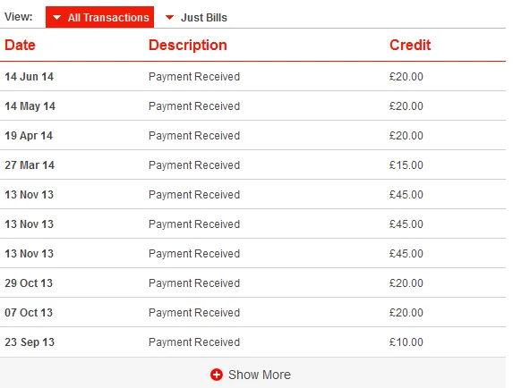

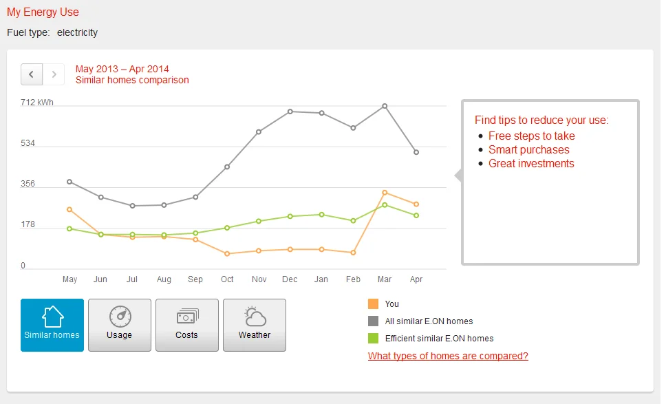

2 People, 42 " tv, Ps3, Pc with 2 monitors, Laptops, 2 Phones being charged + a Tablet,Tumble dryer, Fridgefreezer, Washing Machine and Electric Oven. uses about 200kwh per month it seems
My Gas bill on the other hand makes my eyes water :(
